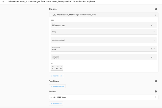

Automation home to not home:

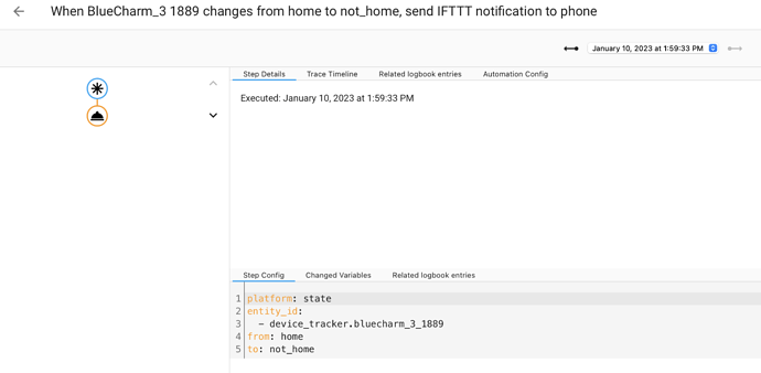

Automation home to not home traces:
