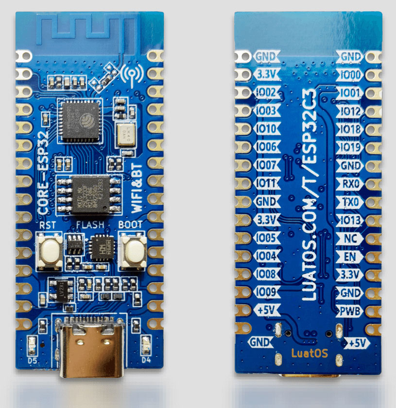

Anyone get the LuatOS ESP3C3 to flash from ESPHome?
A few weeks ago, I bought a few of these boards:
LuatOS CORE-ESP32-C3
Two reasons, 1- they were breadboardable and 2, they were cheap.
Since I have a lot of experience with ESP82xx modules, I thought that using these dev boards would be an easy way to move into ESP32.
But after a few days of searching, Googling and AI conversations, nothing works. I am unable to flash it with a simple LED blink configuration, and it would never connect over WiFi.
So, has anyone gotten this board to work? If not, I’ll put it in my junk drawer and select a different ESP32 board. Also, I’ll entertain suggestions for which board that meets my desire that the board be breadboardable.

One suggestion, the board appears to have a CH343 UART-USB chip, so the logger configuration will probably need hardware_uart: UART0 since that presumably means the on-board USB interface is not being used.
If you want any more help, upload the log when attempting to flash.
Yes :point_down:

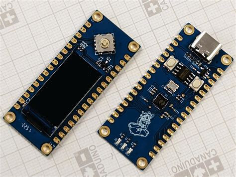

The board is actually with dedicated serial chip available, like in the photo of @stevemann and widely available for around $2 but also without (still perfectly fine flashable over usb via the internal esp32-c3 serial probably) which saves a few cents making it a sub $2 purchase :money_mouth_face:
Also a cheap colored display with cursor control that fits just on top is available cheaply :tv:
