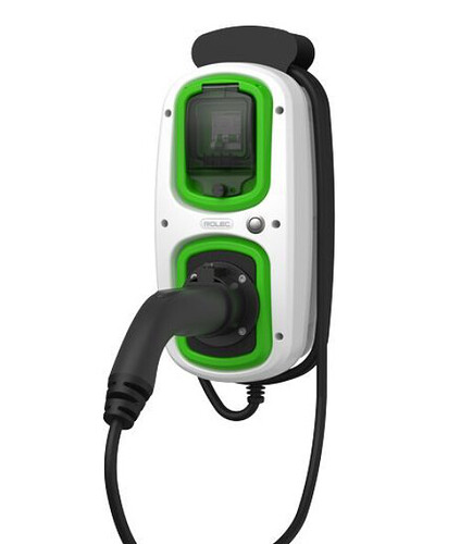

Anyone interested in adding smart control to a dumb ROLEC EV Charger
A couple of years ago I pieced together various bits of info on how to add:
  1. Start and Stop control to a 7KW ROLEC EV Car Charger
  2. Charge Rate control to the same charger
The first part - is simple, and can be done very easily, using any contact controller to interrupt the charge control wire.
The second part was more complicated and needs a bit more kit.
If its something that might be helpful or useful, I will do a write up. It has been reliable for a couple of years and allows the dumb charger to become smart and consider excess solar to control the charge rate (I do that using Node Red but of course possible in Hass automations too).

Also I am looking to get a Rolec Zura and I wonder if any of this would be applicable.
I think the zura is already smart charge, though not sure what the internals are. This could work but I really don’t know. Its for controlling the Mode 3 Controller, which may be inside it. As per this page 16/32 Amp Rolec Communication Unit
