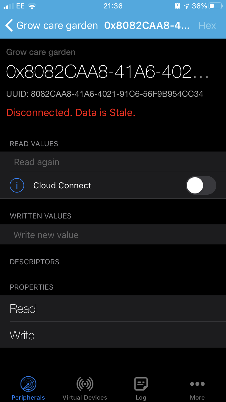

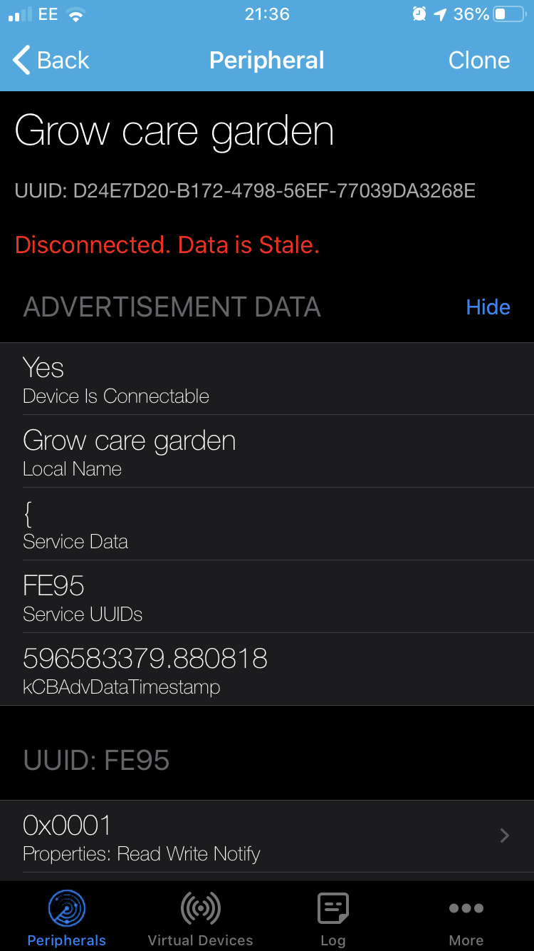

Thanks. I have a similar program on iPhone I used when trying to get the MAC address. This data is not for while the temp etc was changing it’s just screenshotted from connecting to the device. If it’s of use I can play around with changing the temp
These data seems to be the available properties for connection.

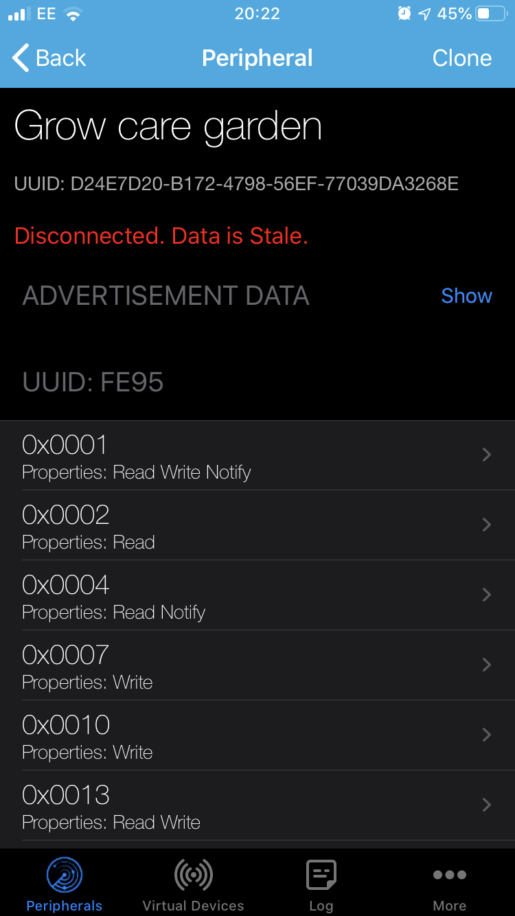

A mi flora can also broadcast its data (added to the connection method). But these broadcasted service data doesn’t seem to show up there.
Maybe you have to click on Show in blue of the first screenshot to see the service data.

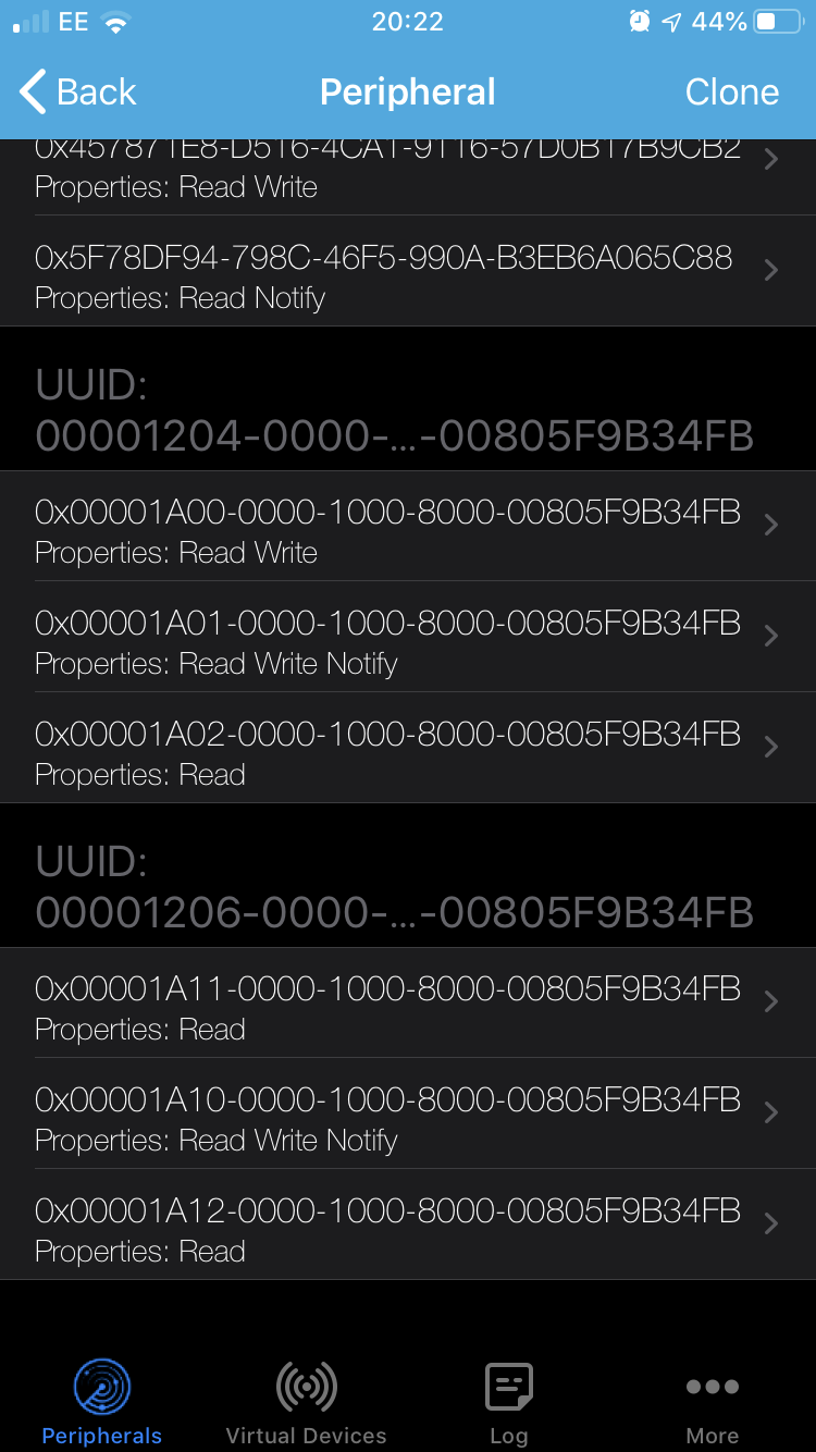

A couple more screen shots. I will take the sensor to work tomorrow and use my work android phone and the app you’ve suggested at least then we can see the same screens.

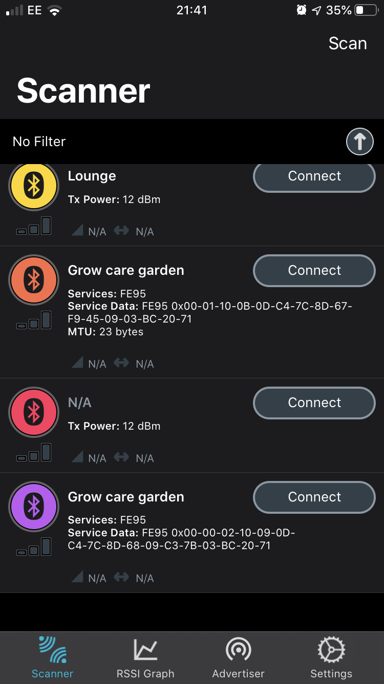

Using another app I can see this:

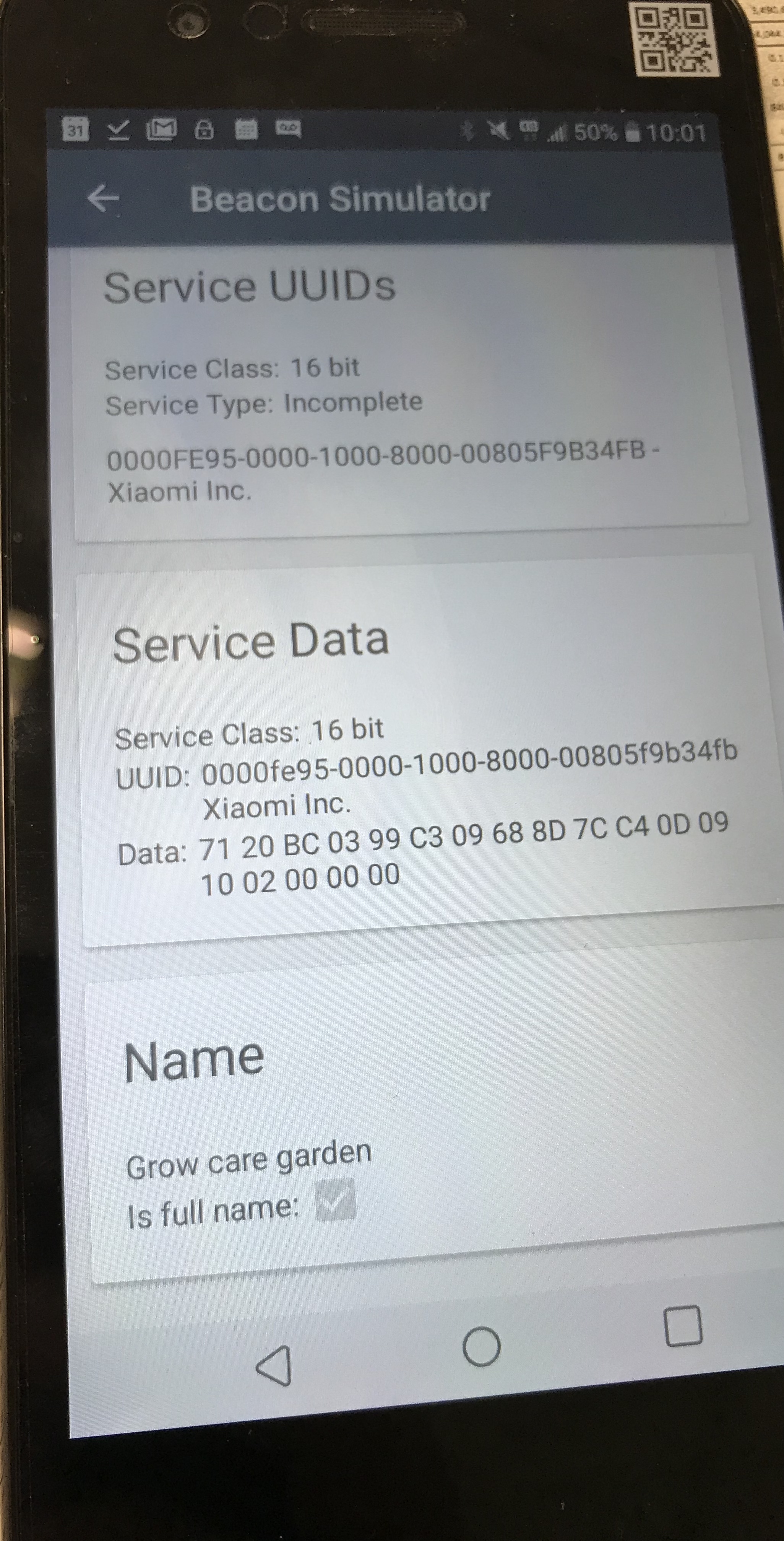

Got the app you suggested. Looks different though but here’s a screen shot.
Let me know what you think. Interestingly it says xaiomi in the name so thinking I will at least try and connect it to esp32 just not sure if the data will be understandle, HA direct doesn’t seem to like anything but battery
Thanks for the screenshot, it can be read by an esp32.
Regarding the firmware, with OpenMQTTGateway I would need to do some modifications. Indeed the service data differ from xiaomi one.I will do them this WE. If you are interested you could test them.

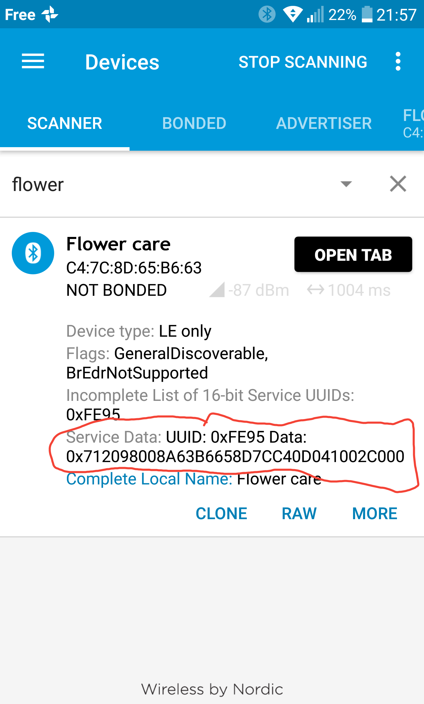

If we do a rapid comparison of the service data from the vegtrug:
7120bc0399c309688d7cc40d0910020000
and the mi flora
71209800bc63b6658d7cc40d0910023200
we can see that we have the same length and some constant in bold.
The rest of the data looks like a mi flora structure.

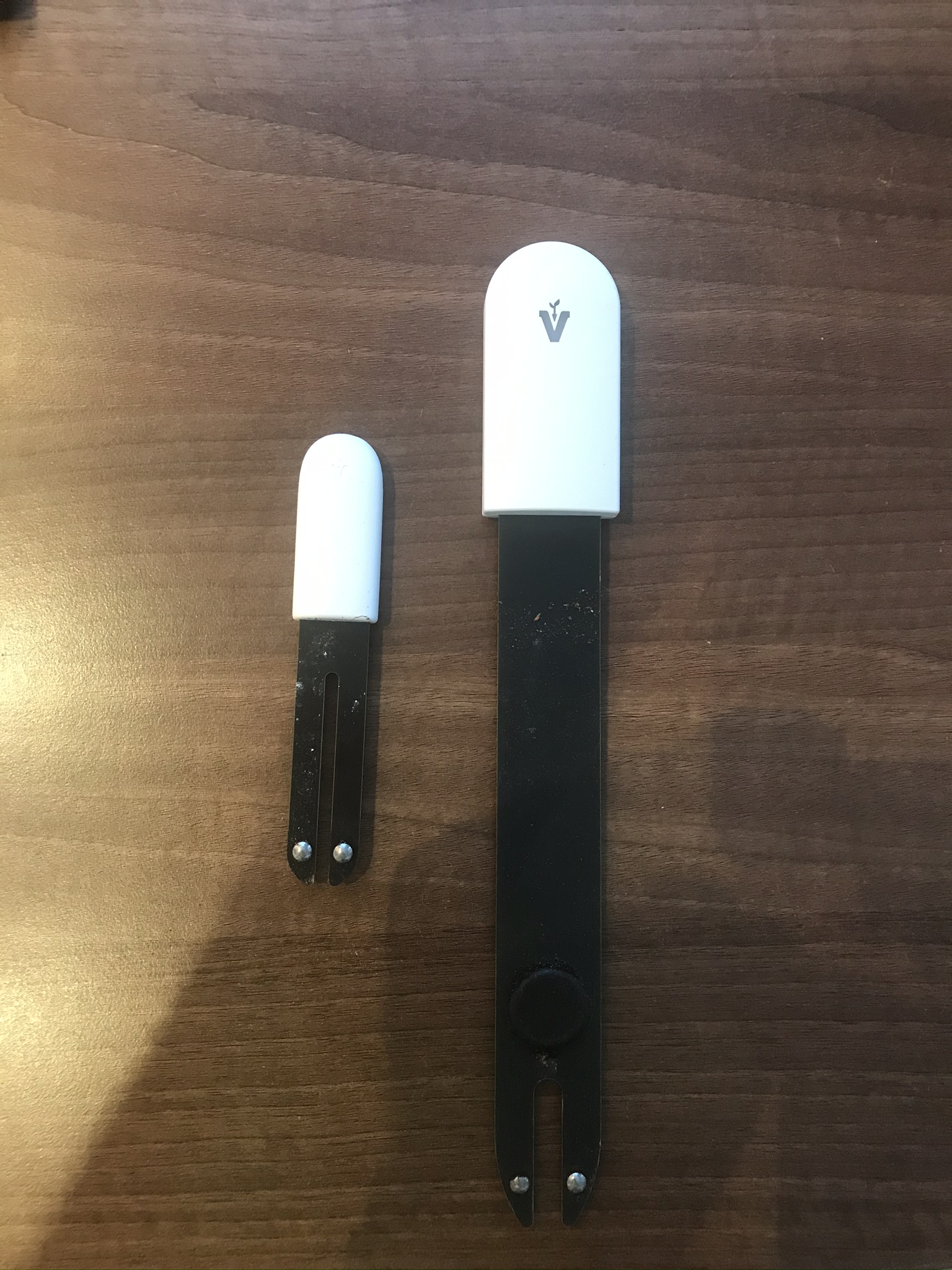

How are the Grow Care Garden sensors working for everyone so far?
I have recharged the batteries once already. This is a bit puzzling to me. Compared to the small sensors where is all that power used?
It cant be the beacons because it broadcasts way less frequently than the small ones.
2 of the 3 I got only show 0% moisture all the time now.
2 of them are not able to finish syncing in the vegtrug app.
Seems there’s been a little confusion which is the Grow Care Garden as compared to the smaller one so just including a picture.

Also - in your photo, the veg trug is on the right, what is on the left?
