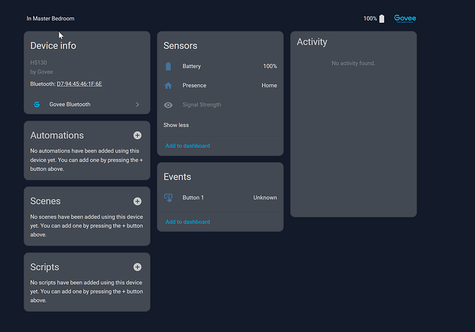

I just purchased them. (Dec 2025) I have them connected via bluetooth proxy and they do show up in home assistant, but WITHOUT a PRESSURE BINARY SENSOR. From the official Govee integration it is a supported device, but the pressure sensor is not one of the sensors listed. The presence senor IS listed, so I guess Im happy to know it’s home. :grinning:
If I dont find a solution soon, Ill, return them.
The Presence sensor indicates pressure detected.
