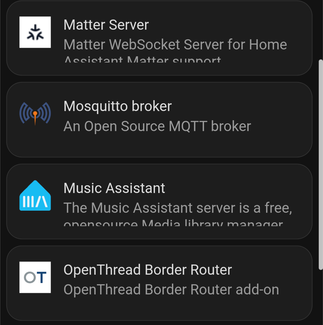

You still probably have to install the Matter Server add-on and then install the Matter (BETA) integration after installing the add on.

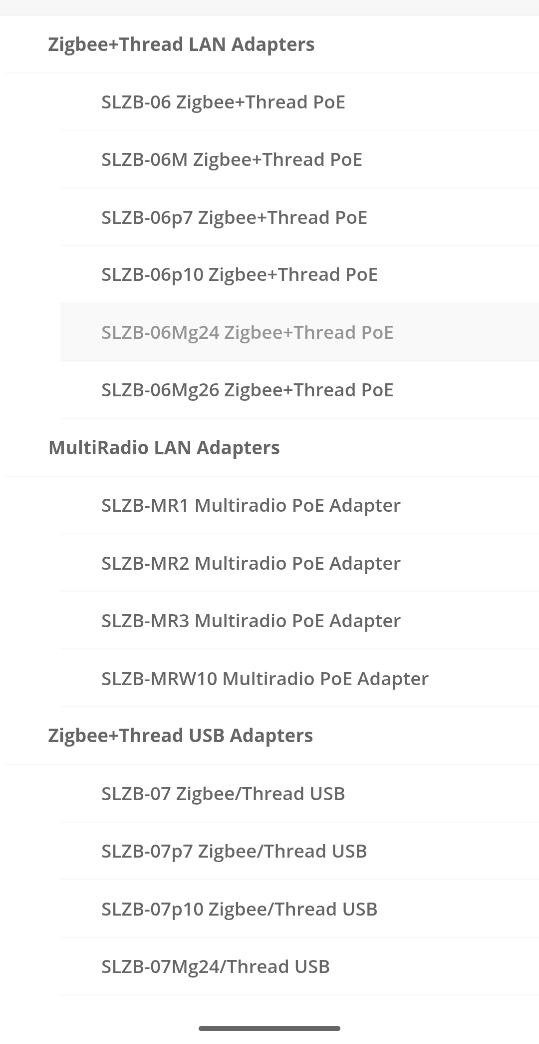

You didn’t get it 07p7 or 07p10 did you?
Those only do ZigBee.

Looks like all SLZB06 POE and SLZB 07 USB models now support thread (experimental) but were is it not experimental . USB models have UART for USB chip for flashing via a computer using a web browser just like a lot of ESP32 based devices.

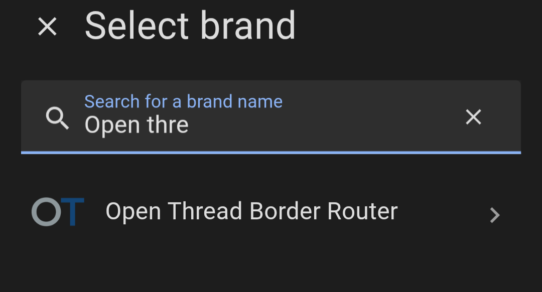

I realize it’s been almost a year since you posted this, but can you share your configuration settings for the Thread Border Router Add-on to get it to work with the SLZB-07?
I flashed the device to work with Thread, I installed the thread border router add-on, but the add-on keep crashing. The logs show the following error:
s6-svlisten1: fatal: /run/s6-rc/servicedirs/otbr-agent failed permanently or its supervisor died
Did you install the Matter add on and Open Thread integration also?
Look for a YouTube video from smlight with Ukrainian girl. It is for slzb 06, but worked for me on 07p7
