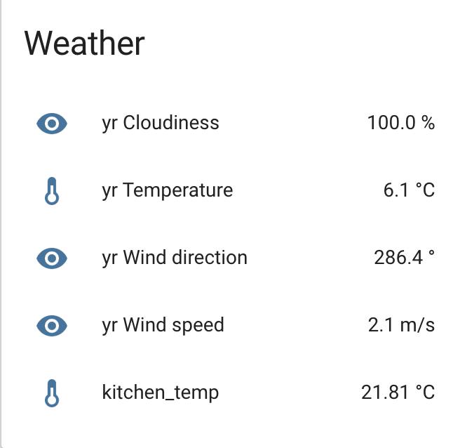

Another quick question, looking in ESPEasy at devices I can see the temperature and using MQTTLens in Chrome I can see that the info is coming in at /ESP01/temp/Temperature so I added the following to my yaml:
sensor 4:
platform: mqtt
state_topic: “ESP01/temp/Temperature”
qos: 0
unit_of_measurement: “C”
HA just shows unknown C for some reason
By default, ESPEasy uses a / in front of the topic. Is that still in play?
state_topic: "/ESP01/temp/Temperature"
woho, Thanks that worked!

I am facing a completely different issue, so couldn’t go to HA part yet. The issue I am facing currently is the connection issue with mosquitto server which is hosted in a pi3 running hassbian. Interestingly, if I choose the Domoticz MQTT as protocol, then ESP can connect to the broker just fine and send the data as expected. But if I choose any other MQTT, it just doesn’t connect. Weird!! When I was connected to MQTT broker using Domitcz MQTT, I tried to check how the mqtt messages are presented with the help of mosquitto_sub. Unfortunately the JSON structure in this case is not easy to use. As an example, my test DHT sensor data is presented like below:
{..."idx": 1, "DHT" : "Temperature 17 ; Humidity 85;0" }
As you see, the data structure is not suitable to pick via Template ?
By the way, I am on EspEasy R120_4096 firmware. Any suggestion ?

@garvarma Thanks a lot for your quick reply. But I am afraid I really understood your comment properly…
I am trying to attach several sensors(Temp/Hum , Lux, Motion) to ESP12E (running ESPEasy) and send the data via MQTT and eventually notify Home Assistant. In my case, HA and Mosquitto Broker is running in different pi. As I mentioned, I can read the sensor data and it can be send to the broker but only if I choose the protocol as Domoticz MQTT not OpenHAB MQTT. And I have no idea how to achieve the value from the JSON format I posted. I though it should be something like … {"DHT Temp": 17 , "DHT Hum" : 85 ...} in that case, it was just a matter of picking the value and show in the weather group.
