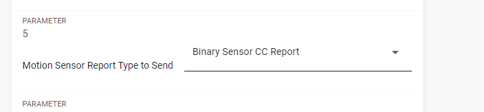

I seem to recall from when I set mine up that you need to configure parameter 5 to report motion as a Binary Sensor CC Report:
Thanks for the advice. I adjusted based on what you recommend.
Still nothing detected. Anything sleep state of the device? Is the sensor perpetually on? Do I need to restart HA for it to take effect? Thanks

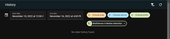

manual trigger, the sensor turn on.
manual trigger automation, lights went on.
automation doesn’t run though.
What could be the issue? Thanks
It might be working now based on the post above.

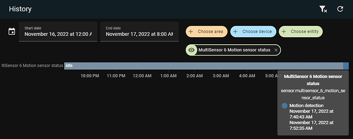

Like what you said there are 2 similar worded sensor
binary_sensor.multisensor_6_motion_detection ← does the detection ( so I wanna use this right? )
sensor.multisensor_6_motion_sensor_status ← output of the detection
not sure why they didn’t incorporate both together or this is not the normal convention whereby input and output needs to be separated. Thanks

it’s partially working. it still didn’t toggle though.
based on my limited knowledge , the toggle should be from binary and not sensor.
What I did for troubleshooting?
  1. Manually run automation. Light is UP ( output working )
  2. Manual software toggle . Automation is UP
  3. hover hand, nothing happen. Sensor is down.

The motion sensor entity is a binary_sensor which will be on when motion is detected. If you can see the binary_sensor change state when it detects motion, then the problem is with your automation, not the multisensor.
I think problem is this toggles
instead of the

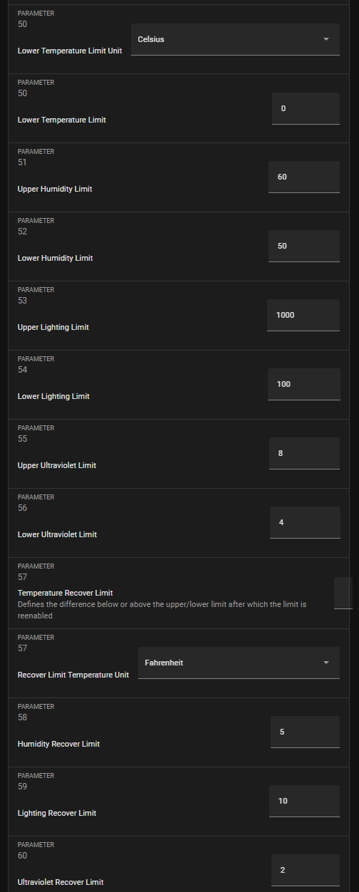

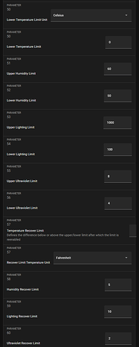

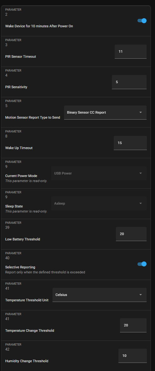

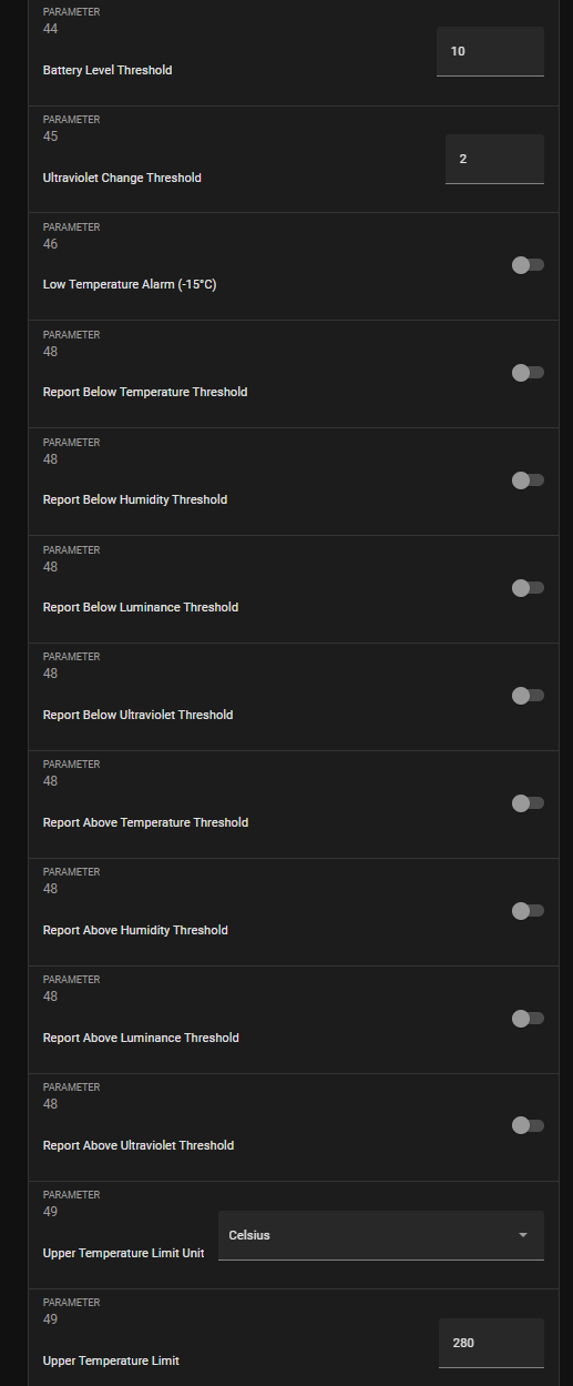

Full configuration ( click image to enlarge)
@nealthomas21 may I trouble you to help mecheck my settings above? Is it a firmware issue or config issue? Thanks
I think it’s a config issue. Turn off “Wake Device for 10 minutes…” and set “PIR Sensor Timeout” to 20 seconds. Can you show Parameter 101 and 102?
Depending on what Parameters 101 and 102 say you may need to unplug the USB, let it sit for a few minutes and plug it back in or do a reset. Parameter 9 is read only and it says as “Asleep”, it should say “Always awake on USB power”.
I did an unpair, reset, pair? Can’t seem to change to ‘Always awake’
How does one toggle to “Always awake on USB power” LOL?
Do you have a battery you can put in it? Put a battery in it let it read that it has a battery and then connect it back to the USB.
