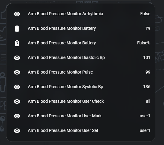

I managed to link this blood pressure monitor to my Smart Life app.
Can this be linked up to the espHome BLE proxy?

you can use this integration silvanfischer/tuya_sensors: HomeAssistant Integration for TuyaCloud Sensors (also unsupported ones)
nice, are you using the same AOJ-33B too?
yes, same device
