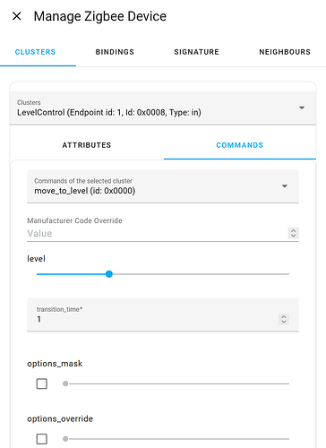

Just set these up with ZHA and seem to work well. Only problem is that the backlight brightness doesnt get exposed so not sure how to control it. I can manually go into manage zigbee device and set it from there but no idea on how to do it any other way.
Has anyone managed to expose the brightness settings?
Not that it’ll help you but it is exposed in Z2M. Maybe open an issue on github and see if someone can add it in

work first time with sonoff zigbee usb and zha only thing can’t see how to turn off led lights in sockets

A config option absolutely buried out of sight!!
I have dozens of these sockets and in the bedroom they are far too bright!!
