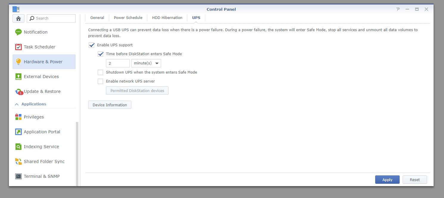

Hi! Old post from you, but do you have a tut how to enable NUT server in a DS?
I can make a quick walk through later if needed.
Take a look under power settings. Then UPS, you have to have the UPS connected to get the options IIRC.
Then the setting should be there.
Would be great!
The APC UPS is now connected to the Syno NAS.
Click the “Enable network USP Server” button.
I would then limit the “Permitted DiskStation Devices” to only the IP of your HA instance. Might as well keep the access as narrow as possible.

So now i got it working, but not all resources are loading in HA. Could it be because the Syno NAS doesn’t give al the data? I can only see the Data the Syno shows from within DSM.
Click the ‘device information’ button shown in your screen shot above. That will display the information the DS is able to pull from the UPS. Not all UPS models provide the same info. The NUT server (DS in your case) can only serve up what it is provided by the NAS.
