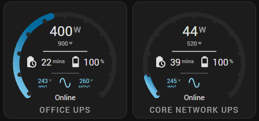

For what it’s worth. Installed an APC Smart UPS lately,via USB to a home assistant running on proxmox 9.1.
  1. connect Smart UPS via usb cable to proxmox host
  2. add the UPS USB device to home assistant VM in proxmox (add hardware, usb device)
  3. restart home assistant
  4. install HACS NUT app add-on (might require a reboot)

Here’s my 2 UPS’ on my dashboard, using some Helpers to convert battery runtime from seconds to mins, and the load from percent to Watts. The APC UPS doesn’t have an output voltage sensor, so that’s why it’s missing in comparision.

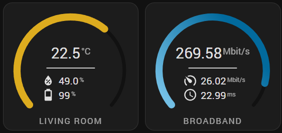

If you don’t mind if I ask, what lovelace cards are these (looks very nice!)?
flex-horsehoe-card, make sure you read the Github guide for it, as there’s a lot of manual entry and fiddling, but once you get your head around how the card design works, you can make something attractive. The Github guide provides examples, and images which each element relates to, and you can copy yaml examples and play around.
