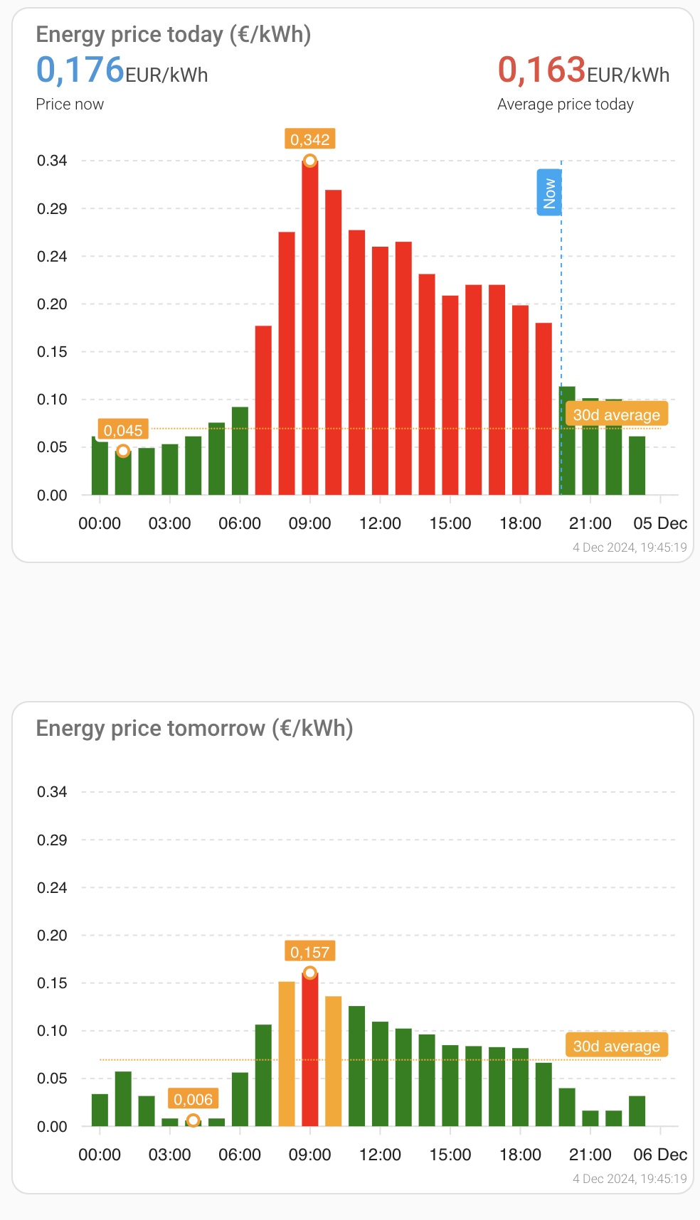

apex_config:
  annotations:
    yaxis:
      - 'y': '{{states("sensor.30_min_anerage_electricity_profit_cost") }}'
        borderColor: '#00E396'
        borderWidth: 4
        label:
          text: mean
Install the config-template-card card and try next:
    type: custom:config-template-card
    variables:
      - '"sensor.electricity_price_today"'
      - states["sensor.30_min_anerage_electricity_profit_cost"].state
    entities: ${vars[0]}
    card:
      type: custom:apexcharts-card
      apex_config:
        annotations:
          position: front
          yaxis:
            - 'y': ${vars[1]}
Perfect, thank you!
