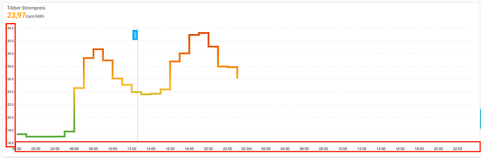

Is there a way to change font/(font-)size/(font-)thickness/line thickness of the red marked x- and y-axis values and lines!?
I’ve tried to search and figure out that how could I get my column graph so that the left side of the column would be at the start of an hour like I’ve seen in many pictures here.
The code for the chart looks like this but this makes the graph so that the x-axis hour is at the middle of the column and for exampl no when it is 17:52 the “Now” line is already on the next hours column
type: custom:apexcharts-card
graph_span: 24h
apex_config:
  chart:
    height: 300px
    width: 470px
  yaxis:
    tickAmount: 5
    forceNiceScale: true
show:
  last_updated: true
experimental:
  color_threshold: true
header:
  title: Päivän Nordpool 25.5%
  show: true
  show_states: true
  colorize_states: true
span:
  start: day
now:
  show: true
  label: Nyt
series:
  - entity: sensor.nordpool_kwh_fi_eur_3_10_0255
    show:
      extremas: false
      in_header: raw
      header_color_threshold: true
    type: column
    float_precision: 3
    data_generator: |
      return entity.attributes.raw_today.map((start, index) => {
        return [new Date(start["start"]).getTime(), entity.attributes.raw_today[index]["value"]];
    color_threshold:
      - value: 0
        color: darkgreen
        opacity: 1
      - value: 8.82
        color: goldenrod
      - value: 12
        color: darkred

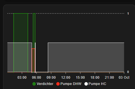

Hi, I want to create a daily chart (from 0-24hr).
Is there an option to display all “future” values with 0?
In this example the “Pumpe HC” is running since 08:30. I want to achieve, that the graph after the current time (08:50 atm) returns to zero.
  • entity: binary_sensor.thz504_pump_hc
    yaxis_id: second
    color: white
    transform: ‘return x === ‘‘on’’ ? 0.5 : -0.1;’
    type: area
    curve: stepline
    opacity: 0.2
    stroke_width: 1
    show:
    legend_value: false
Edit: Got it!
extend_to: now

Likely (never 100%) nothing with apexcharts, did you check your sensor data?
First: thanks for the idea :slight_smile:
No clue how it works with more than 2 but …
In my chart I only have 2 axis defined
EDIT: the solutions came from browsing apexcharts.js
There is a lot of pictures here that are for electricity price and they have the MIN, MAX and AVG in the header and I’ve added that too.
Now I’m wondering that how could I get so that the color of those would also change based on the value?
Below the code for Average as an example
    attribute: average
    float_precision: 2
    group_by:
      duration: 1d
    show:
      in_chart: false
      legend_value: false
You can try to use the config-template-card (example a few posts back), that allows you to add ‘templates’ instead of fixed values. I however do remember that depending on the sensor (with/out data_generator) it may not work
