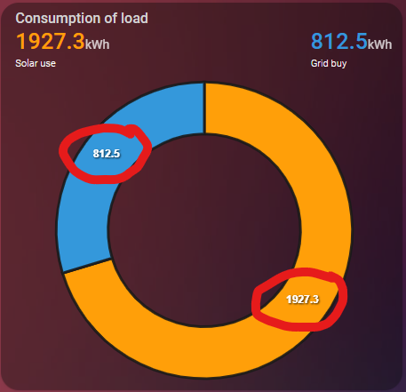

Hi!, can someone helpme to make this image
to look like this one image
here is my config
type: custom:apexcharts-card
chart_type: radialBar
experimental:
  color_threshold: true
header:
  show: true
  title: ApexCharts-Card
  show_states: true
  colorize_states: true
apex_config:
  plotOptions:
    radialBar:
      offsetY: 0
      startAngle: 0
      endAngle: 270
      hollow:
        margin: 5
        background: transparent
        image: false
      dataLabels:
        name:
          show: false
        value:
          show: false
series:
  - entity: sensor.energy_month
    type: column
    show:
      in_header: true
      extremas: true
    float_precision: 0
    color_threshold:
      - value: 30
        color: blue
        opacity: 1
      - value: 50
        color: cyan
      - value: 80
        color: green
      - value: 170
        color: orange
  - entity: sensor.gastoelectrico_estimado
    type: column
  - entity: sensor.gastoelectrico_actual
    type: column
i’ve tried this setting Custom Angle Circle Chart in React – ApexCharts.js but no luck at all

I understood a few releases ago, the donut chart behavior changed to show the value instead of the percentage. However, I really liked the percentage :smiley:, but I can’t get it back. When this behavior changed, the release notes said the old behavior could be enabled with datalabels: percent, however this doesn’t work for me. Does anyone know how to show the percentages in the different donut parts?
header:
  show: true
  title: Consumption of load
  show_states: true
chart_type: donut
series:
  - entity: sensor.pv_total_solar_use
  - entity: sensor.pv_total_buy
apex_config:
  datalabels: percent
  legend:
    show: false
After using the following code
i got this output
as for individuals, i get 225 as expected.
how can I do some operation on value?
But is the problem now the value or the state? Sorry, I may be completely off base here, but would you not need to format the state? Not sure if the state value is automatically formatted identical to in-graph values.
I think I am formating the value of the state :-/
