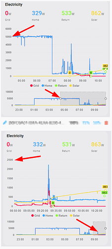

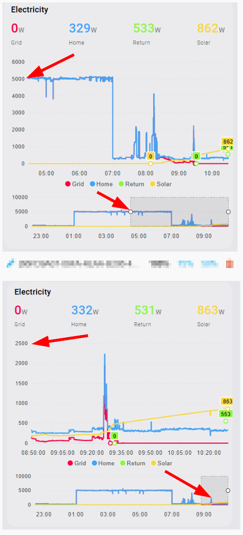

It does the exact same thing to me too, I’ve tried everything, but the y-scale is set to the maximum value found in the contents of the graph_span: range and not as it should be in the selection_span: range.

I am attaching some screenshots, as per my previous post:
… is it a bug to report or is it a problem with my code?

Hi all,
Anyone found a solution already for this issue?
I have a graph that once in a few days shows some bursts but for the rest very small values. And the beauty about the brush in the original Apexchart.js is that it zooms in the y-axis automatically
Hi all,
It’s been a while since last post, but it seems this library bug was fixed. Check this behaviour setting autoScaleYaxis to true in brush section:
brush:
autoScaleYaxis: true
Best,
