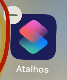

its here I should create the automation correct ? Do work with HA toggles

No. What you’ve circled is the Home app (not the Shortcuts app, and it isn’t HomeKit).
