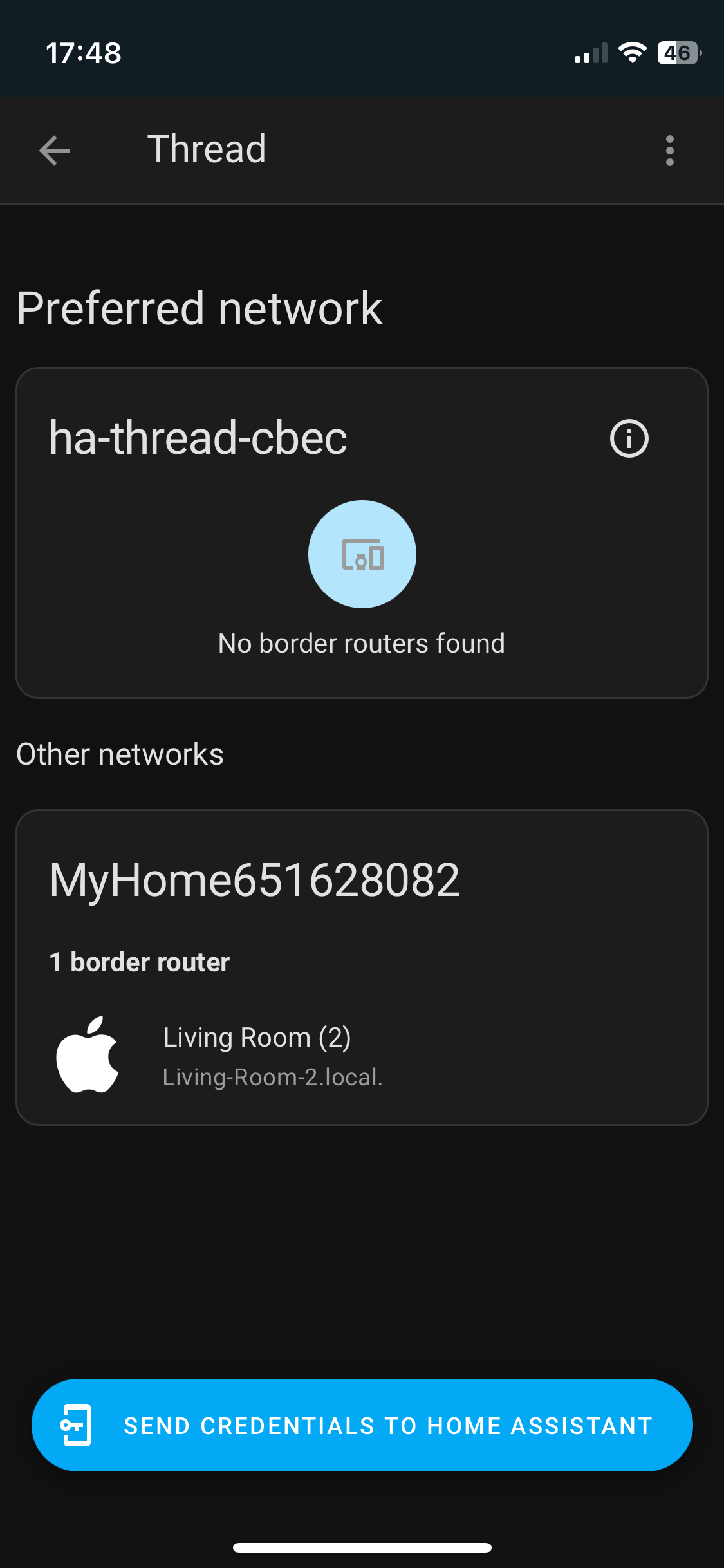

Any idea why the new network was created in the first place? I have the same issue. All of my devices were connected to a different Apple thread network, and then after a reboot I got a new network and all of my devices were no response. I was able to re-add the devices to HK. But I can’t seem to use the HA app to send the credentials for the new network. My iCloud keychain is storing the old ones.
Any idea how to edit the keychain if you don’t have a Mac computer. I have an iPhone and iPad but have found no solution.
I tried this but the old one still shows up. In fact the old one is a previous home assistant thread border router instance which is now deleted but it still shows up.
It’s deleted, I deleted it from the keychain, but still no luck. I really wish they would make this section more user editable.
I agree with you, this section is a UX nightmare. I think it still shows up because it’s the “preferred” network, and it will not let you delete a preferred network (even if it has no border routers). But in order to make another network preferred, you need to have one with credentials known to HA. In order to learn the credentials, you have to click the “Send credentials to HA” button. THEN you should be able to make “MyHomeXxx” preferred, and delete the old ha-thread network from this page.

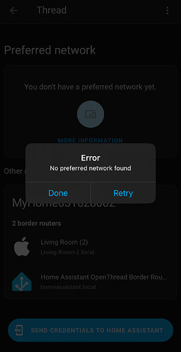

I also managed to create a HA Open Thread Border Router instance and join it to the Apple TV thread network. However, I still can’t add either of these as my preferred network. When I press “Send credentials to HA” button I get “error, no preferred network found”.
My keychain previously had the old network credentials in (eero, HA, a different apple home network?!) so when I pressed it it sent those which didn’t give an error but also did nothing. After deleting those I get the error.
I have no idea how to get the credentials of the current network into my keychain (I think the HA iOS app has to request them but it doesn’t seem to be doing that).

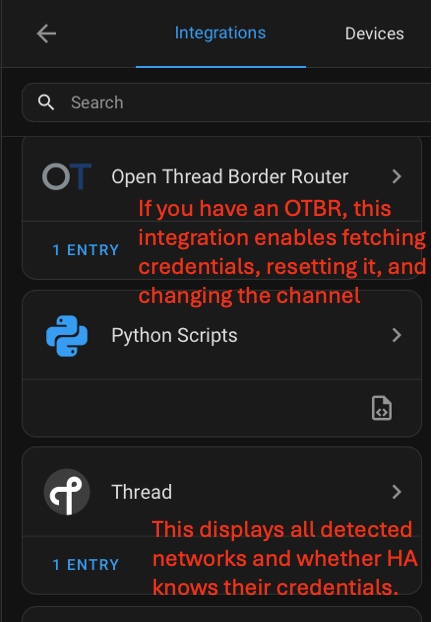

Do you have the OTBR integration installed? In theory that should pull the credentials from the REST API into HA’s Thread integration.
Yep, look at the screenshot. That’s the thread integration right there with the HA OTBR instance. It’ installed and on the same thread network as the apple tv, everything works but I can’t set it as my ‘preferred network’ or get HA to recognise that it already has the credentials or send them to my phone/allow my phone to send them back to HA
OTBR has its own integration, separate from the Thread integration, for people who have OTBR-based border routers. I do not see it in your screenshot.

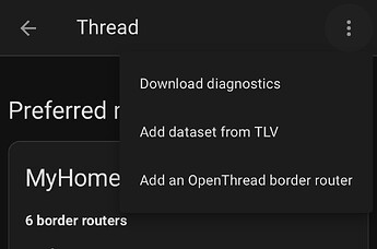

Edited to add: you can also add a OTBR, or a TLV dataset, manually via the Thread integration’s three-dot menu, have you tried that as well?

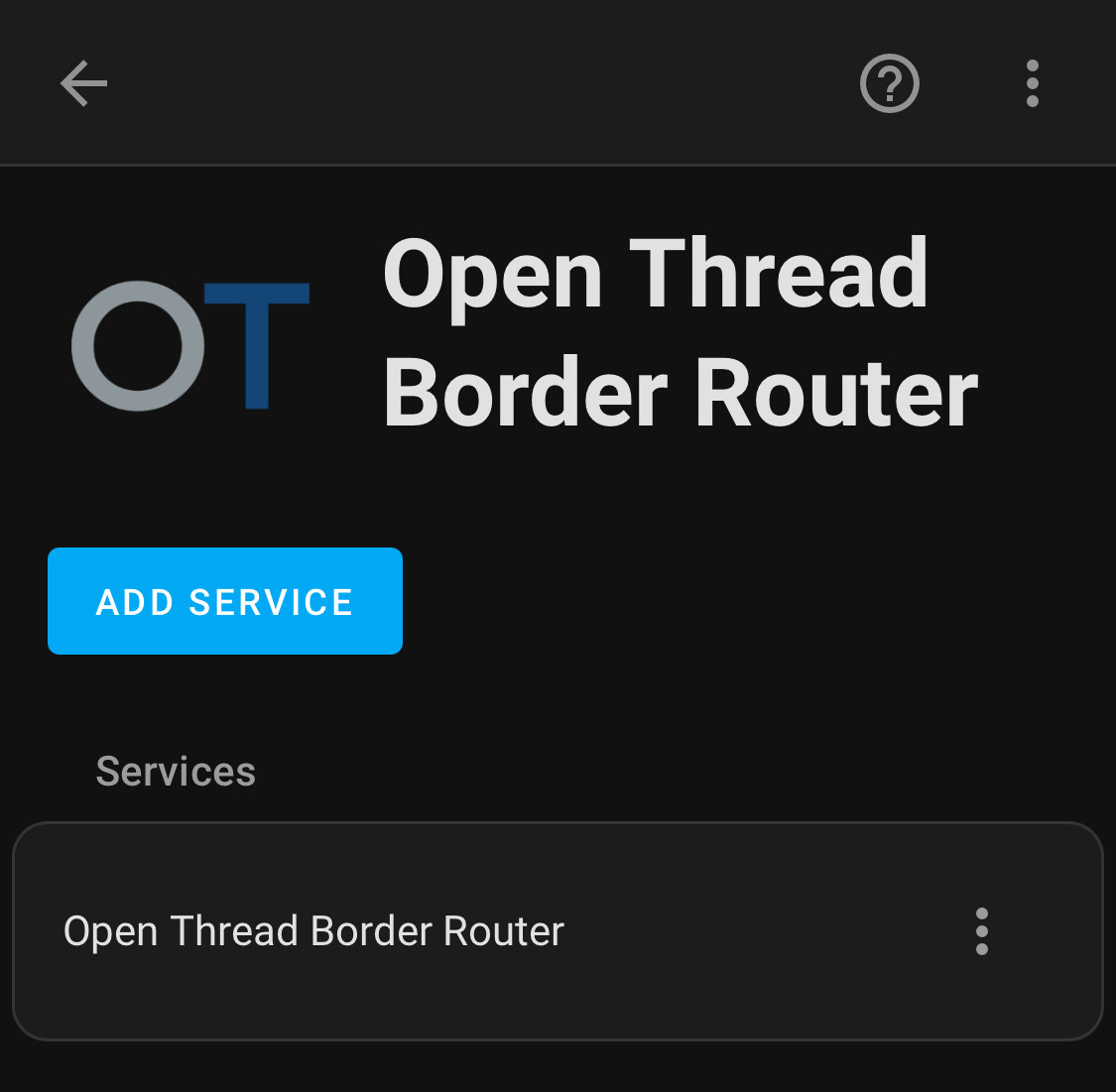

In my screenshot it shows that home assistant is running the open thread border router add on, that automatically installs the otbr service doesn’t it?

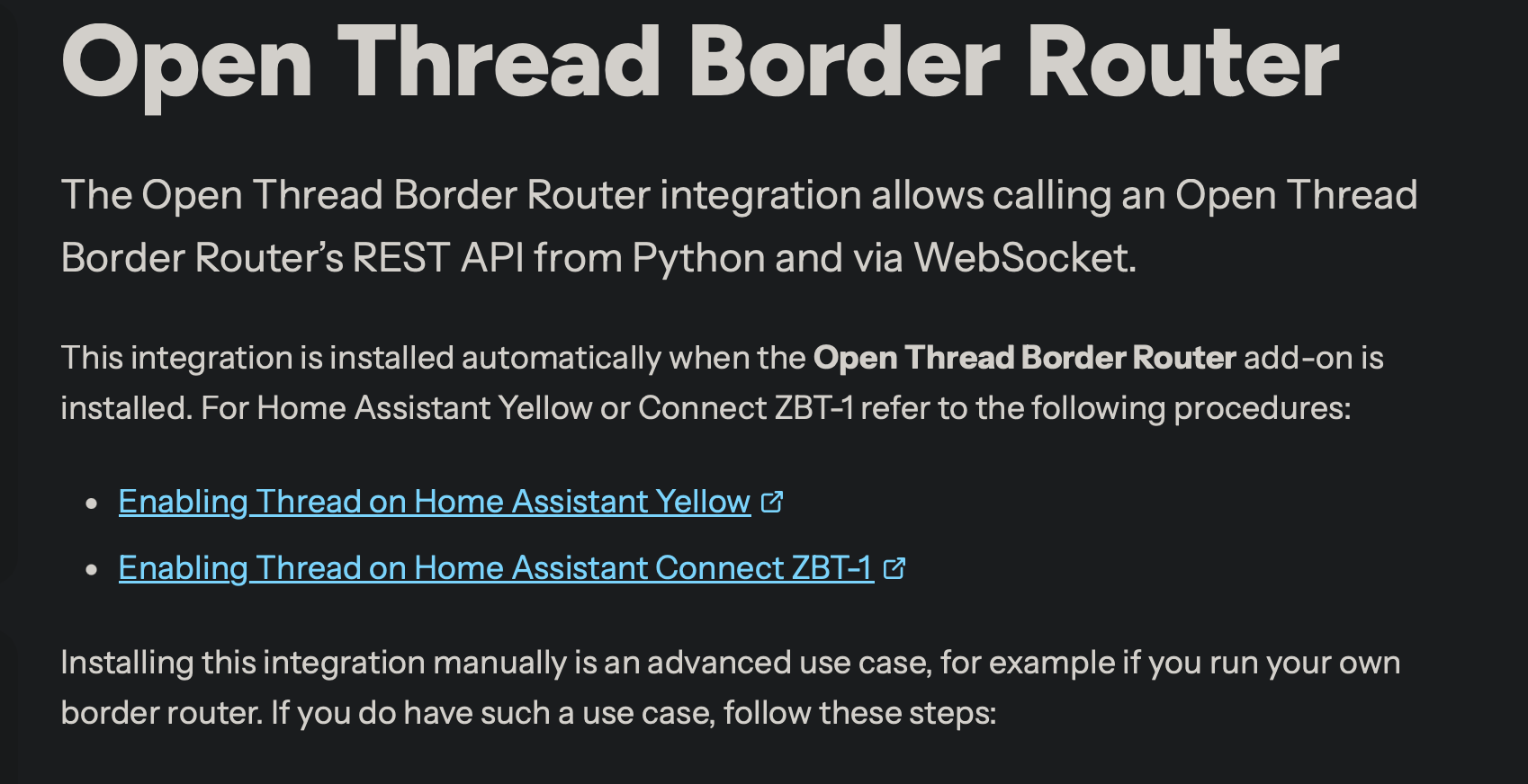

Screenshot of their documentation:
The router is there and added already. Again, look at the screenshot, in the lower part behind the popup. You can see my Apple TV thread router and the home assistant thread router. The router is there the OTBR add-on and service are running. I managed to put the OTBR instance on the same thread network as my apple home via the web GUI. But still non of them have the credentials.

I can see this. And again, the service you need (OTBR integration) is NOT shown, that is on a whole separate page that you haven’t shown anywhere.
Is the pop up hiding the (i) icon? If it is, then the credentials are there and the REST API must be working. If it’s not, then the credentials are missing and the REST API appears to be failing. Maybe at least check it for errors before posting screenshots to the documentation?
