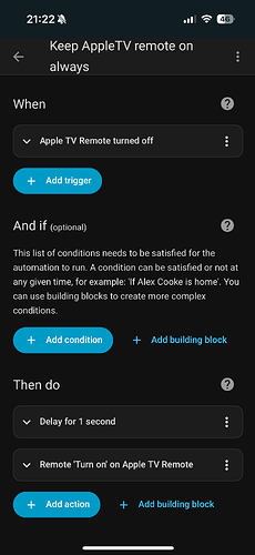

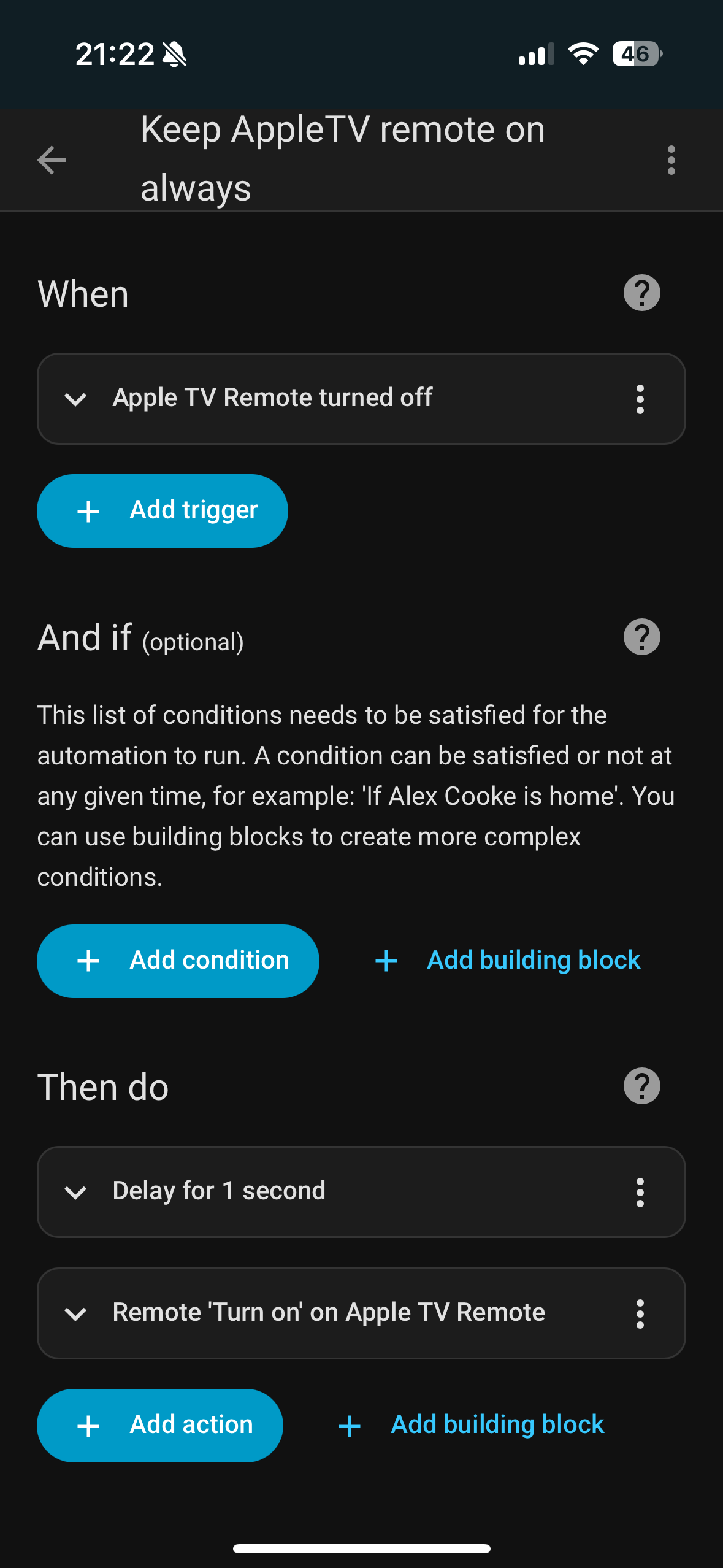

At least for my Apple TVs, the media_player entity state changes seem to be ignored if the corresponding “remote” entity is OFF, and for some reason my remotes tend to randomly turn themselves off, so I had to create an automation to keep them on (which has no effect on the media_player or Apple TV). I’m not sure if this is specific to me, or if there is a better fix, but if your Apple TV automations aren’t triggering and it’s driving you crazy, keep an eye on the remotes.

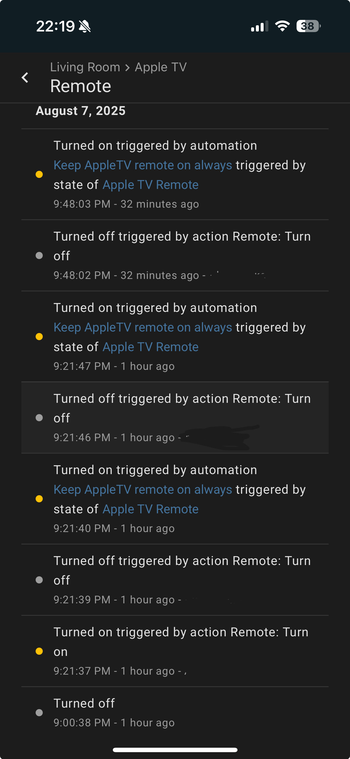

Can you share your automation? This one doesn’t really work. When I turn off the remote entity from home assistant, it turns itself back on. But when the remote entity turns itself off randomly, it doesn’t turn back on. Tonight I had the remote entity turn off while I was watching Netflix on my AppleTV, so idk why it got turned off.
