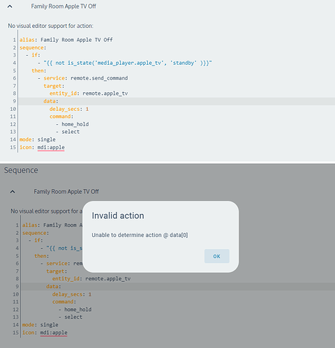

I tried your script and im getting attached error. Can you please help me on what i did wrong
Hi Scott,
works perfect, thanks for the code and idea
have a good one!
Awesome, glad to hear it. Thanks for the note!
I had the same issue… realized that when you start to enter the script… you need to click on the three dots on the top left of the screen and “edit in yaml”. Then paste the script. Edit the alias and change the device to your device id’s and you are all set!

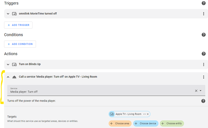

Not sure if this will work for others, but after getting by butt kicked for several hours I found you can just call the service to turn the Apple TV on and off discretely (see image below) - works like a charm.
Hopefully the developers will get the normal method corrected soon.
