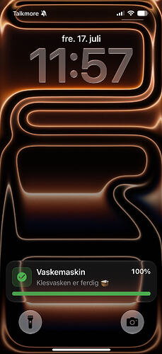

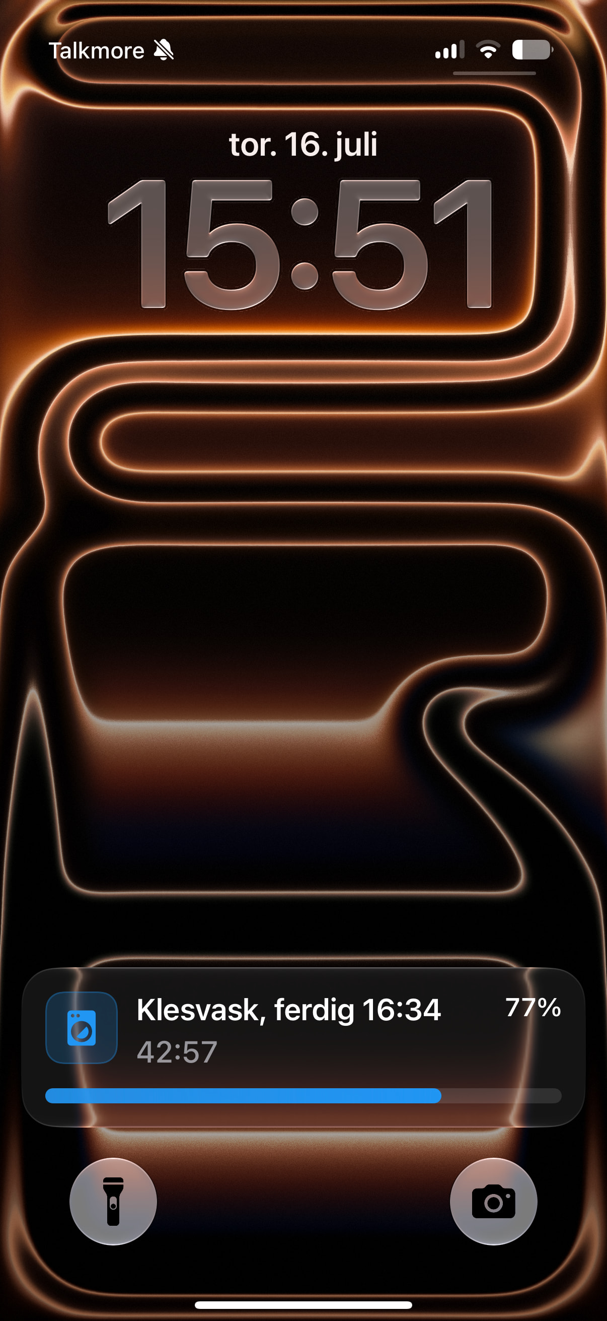

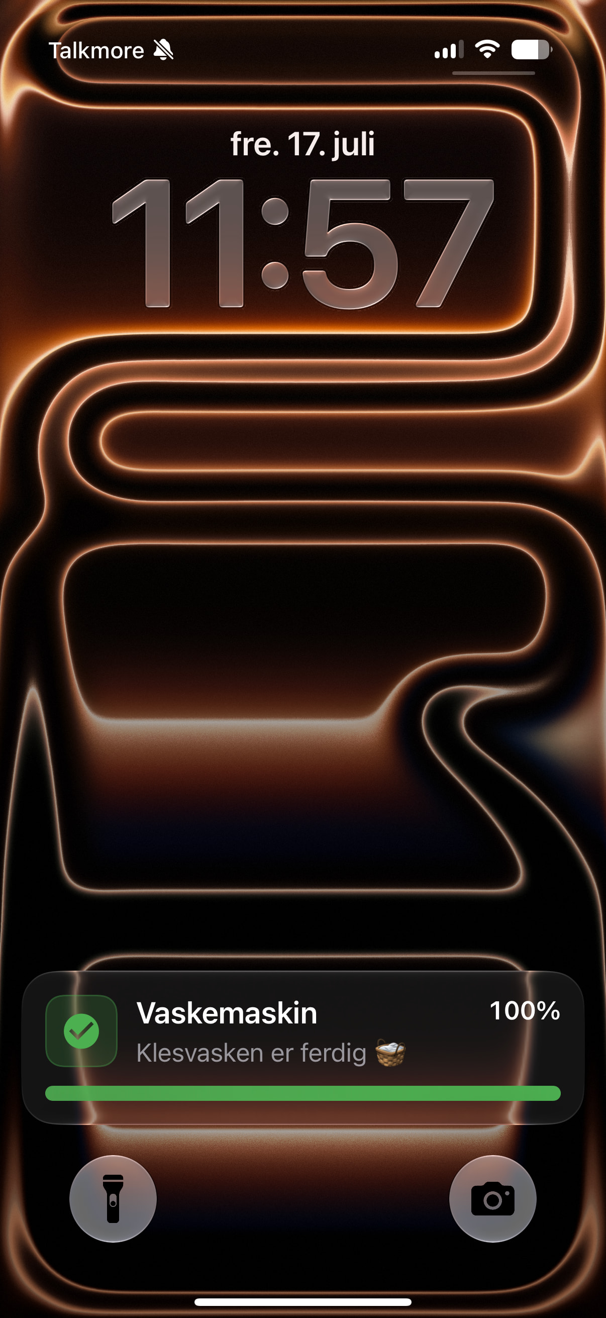

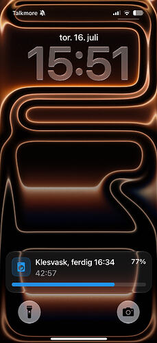

Example appearance
While running:
Washing machine, done at 16:53
01:42:18
████████░░░░ 43%
When finished:
Washing machine
Laundry is complete 🧺
████████████ 100%

In progress – Done
Hey, I love this and use it for iPhone. As my main phone is a Samsung / Android, I can tell you that it only works on iOS. But I would love to see an Android version too!
Thank you! :folded_hands:
What Android version are you running? I see that the Live Activity feature requires Android 16 or newer.
This is super cool! Unfortunately my washer and dryer don’t report start time, only completion. Is there any way around this?
Just a quick feedback from my test.
some appliance’s state is a sensor with numeric raw number, so when checking if the state is in a certain list, it need to be converted into string before use in
i.e.
  is_finished: >
    {{ appliance_state | string in finished_states_list }}
Thank you for the feedback, this is fixed now! ::man_bowing:
See gist for the latest version: [blueprint] Appliance Live Activity countdown · GitHub
Thank you!

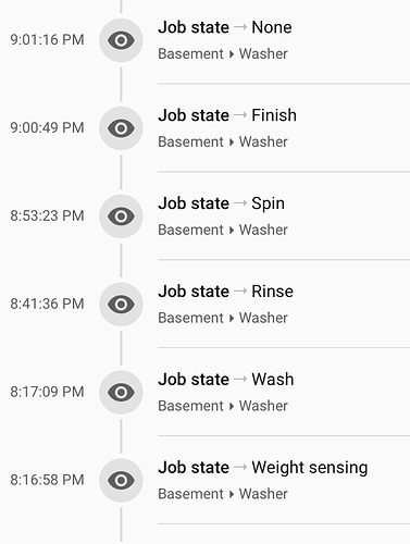

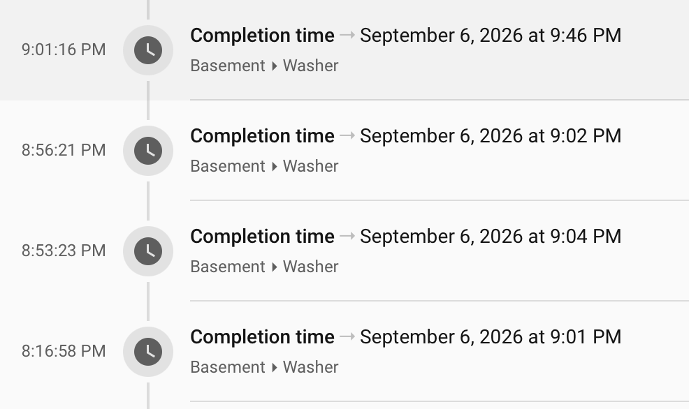

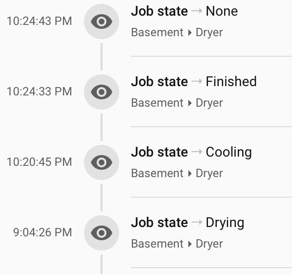

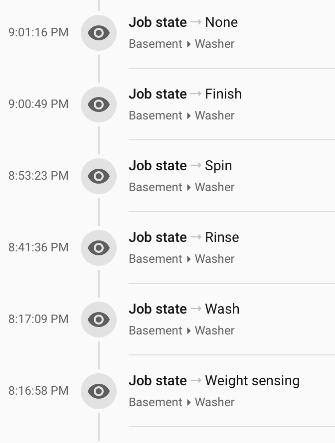

I will look into this, but I have some questions:
  • How does your completion look like? Is it a timestamp or remaining minutes?
  • Does your machine have cycles, or is is just “running” or “not-running”?
  • Does completion change during cycle?
I have a Samsung washer and dryer using the SmartThings integration (for now!). They show the completetion time as 2026-09-07T07:59:08+00:00 but it does change during the cycle. I have two sensors for each, Job state and Machine state. Job state differs with each part of the cycle, Weight sensing, Wash, Rinse, Spin, etc. Machine state shows just Running or Stopped. Happy to help with anything else you need. Thanks!
