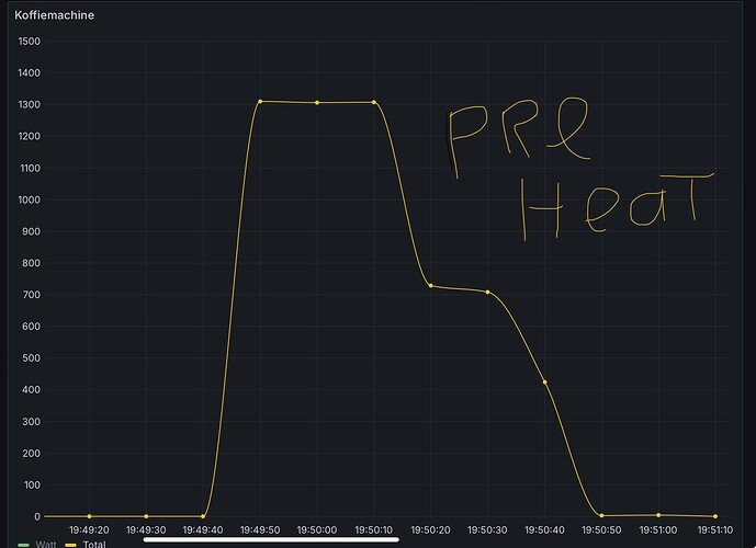

@Blacky ı made a counter which counts the number of cups of coffee prepared by my coffee machine.
the blueprint does increase a counter when a coffee is prepared.
however it does also increase the counter when i just turn the machine on and it starts pre heating.
see attached power usage of pre heating and 2 examples of powerusage when preparing coffee.
how do i need to setup the blueprint to just count coffee preparation?
I played with the settings and shortened the running dead zone and it appears to be working fine. Although it works fine, when I look at the trace it still shows the message " stopped because only a single execution is allowed" after a very short time, but yet it finishes and notifies us. In any case all good now and thanks for the blueprint and your help.
@SuperElma
Handling this with this BP might be challenging, and achieving the desired accuracy could be difficult. Have you considered using a switch instead? While I’m not familiar with the specifics of your coffee machine, for mine, if I wanted to count the number of coffees, I would connect a device to the switch that indicates when a shot or the water pump is ON (like a Shelly 1 Mini Gen3), signaling that coffee is being made.
To prevent false triggers during cleaning or purging, you could require the switch to remain ON for a specific duration, typically 6 to 8 seconds—the typical time for a shot.
I hope this helps you.
Blacky :smiley:
