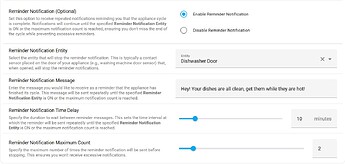

Hi Blacky, thanks for coming back!
This sensor specified here at Reminder Notification Entity is taking care of stopping further reminder once the door has opened.
I was referring more to the initial notification that the wasching maschine is finished. This message remains on the mobile and must be clicked or swiped, it is not cleared by the door sensor, at least in my case.
Greetings, Bastian

@Bastian007
Oh, I see… if you’re using an Android device, you can select the Sticky Notification option in the Start Notify or End Notify settings.
If you’re on iOS, the notification disappears as soon as you tap it… unfortunately, that’s just how iOS works. It’s one thing I really dislike, but I can’t fix it since it’s an iOS limitation.
I haven’t set it up so that the notification clears when the door is opened, because that kind of behavior can only be done on Android devices.
I’ve actually asked the Home Assistant team in a WTH to develop their own unified notification platform… something that works the same across all devices, regardless of whether you’re on Android or iOS.
Right now, it’s a pain having to build in different options for each platform. It makes the blueprint more complex and potentially confusing. Hopefully, HA can eventually link notifications directly to their mobile app and create a more consistent experience.
I’m not sure if it’s possible, but that’s up to the HA devs.
