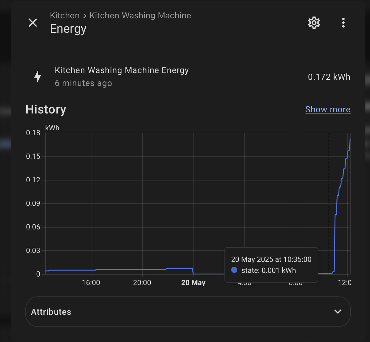

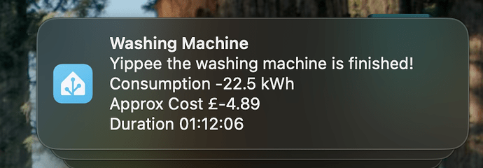

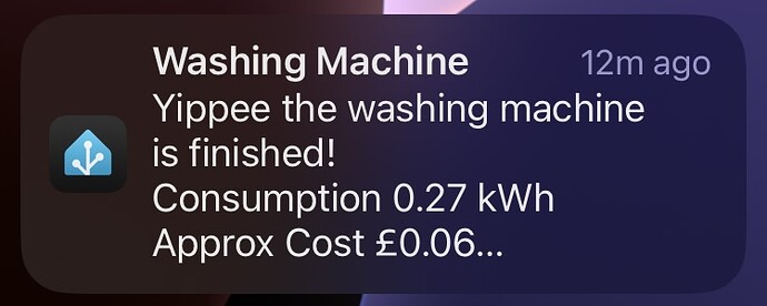

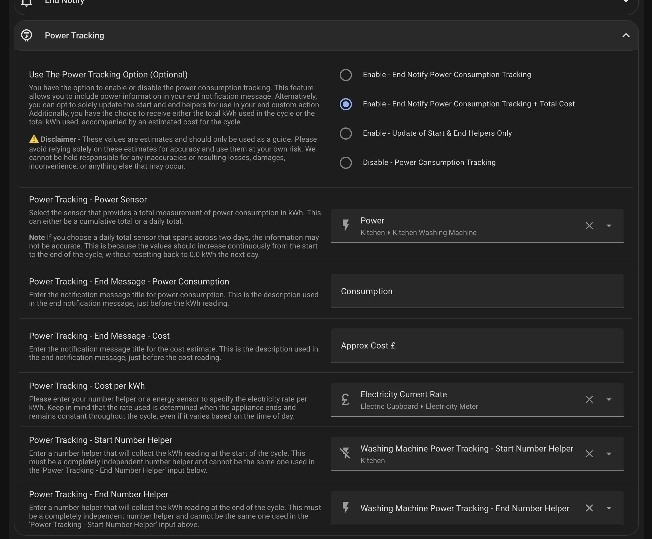

@Blacky I’ve settup this blueprint and works really well so thanks for that, but in the cost and consumption it is no where near correct and also why are the figures in a minus ?
it has used no where near 22.5kWh
alias: Washing Machine Notification

input:
power_sensor: sensor.kitchen_washing_machine_power
include_end_notify: enable_end_notify_options
end_notify_device:
- c1adc20630ba834a1b25584d5414d48c
- 1157c307a9b7d769644e227a645f2d6f
include_power_tracking: enable_power_tracking_and_cost
power_consumption_sensor: sensor.kitchen_washing_machine_power
cost_per_kwh: sensor.octopus_energy_electricity_22j0006288_1591022098690_current_rate
include_duration_tracking: enable_duration_tracking
include_start_notify: enable_start_notify_options
start_notify_device:
end_appliance_power: 5
end_time_delay: 1
watchdog_notify_device:
watchdog_notify_interruption_level: time-sensitive
watchdog_timeframe:
hours: 1
minutes: 40
seconds: 0
include_watchdog: enable_watchdog
start_power_consumption: input_number.washing_machine_power_tracking_start_number_helper
end_power_consumption: input_number.washing_machine_power_tracking_end_number_helper
end_message_cost: Approx Cost £
what have I got setup wrong ?
Thanks for your YAML that makes it easer to find.

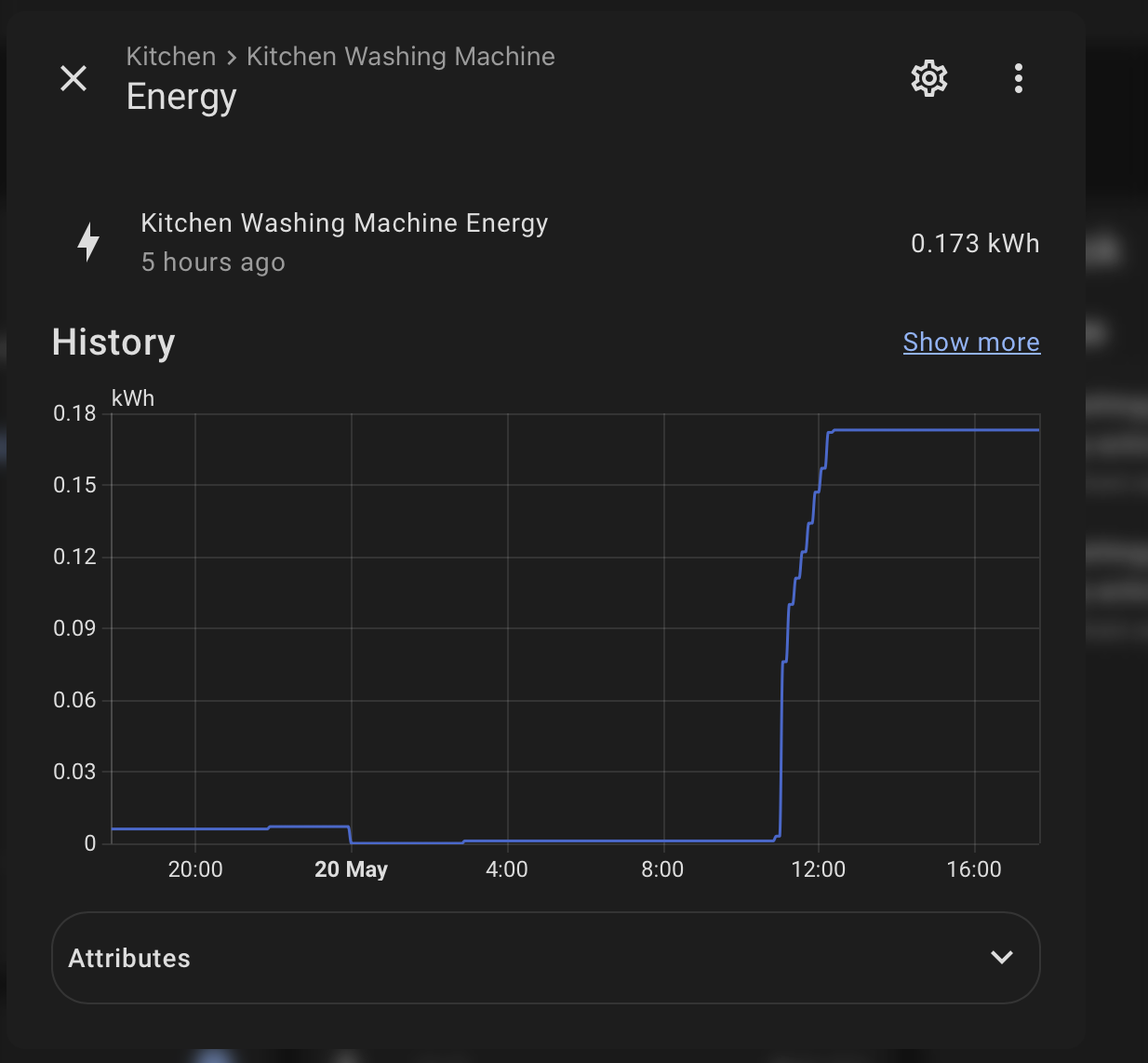

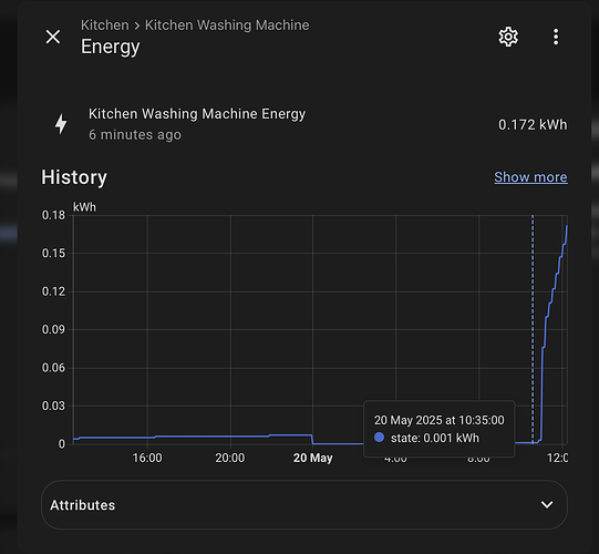

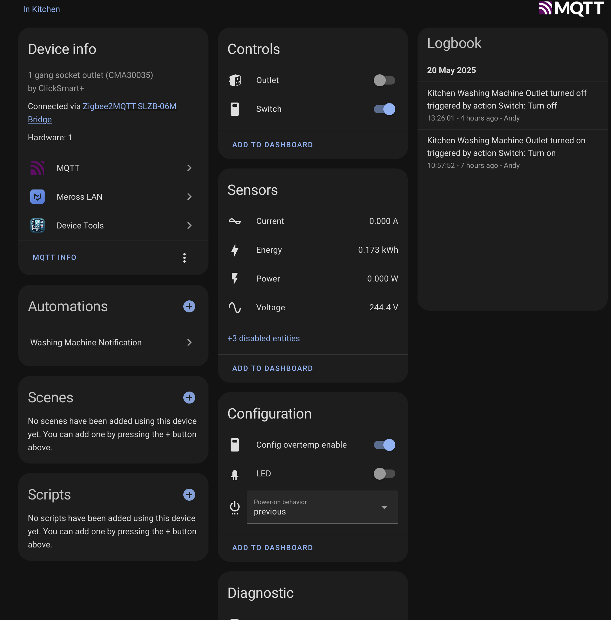

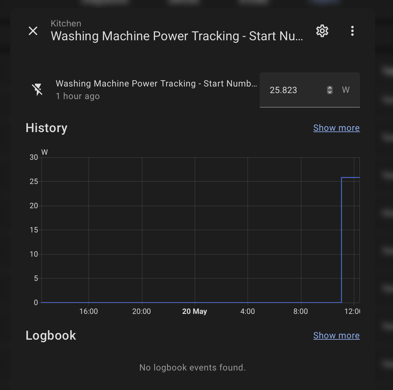

Your using the wrong power sensor in Power Tracking - Power Sensor. Looks like this sensor is the one that uses the actual current draw when running and you have also used it in the correct input Power Sensor.
You need to select the correct power sensor that measures the accumulative power total (normally manufactures of smart pugs reset it everyday so also be aware of this) not the current draw. You can see your Kitchen Washing Machine Energy (this entity) was reset at the start of the day and only increased as the day went. Use this entity in Power Tracking - Power Sensor not your sensor.kitchen_washing_machine_power and you should find that it works.
Blacky ![]()
do you refer Power or Energy?, if the former none of my sockets / plugs support accumulative Power for the day, only Energy.
If you do refer to Energy I suggest you reword your blue print to correct this, as Power refers to current draw, Energy refers to energy used, the two are very different things.

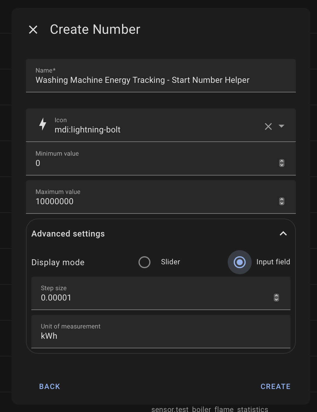

and also the Helper Guide should be updated to show something like this:
I agree, I can see that this can be confusing. I will update it… thanks Andy.

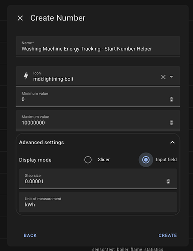

maybe change Step size – I recommend setting this to 0.01 to Step size – I recommend setting this to 0.001 this reports down to 1 Wh used.
It does that anyway, it is just when you use a slider to adjust the number helper. If your sensor reports in 0.001 then it records that.

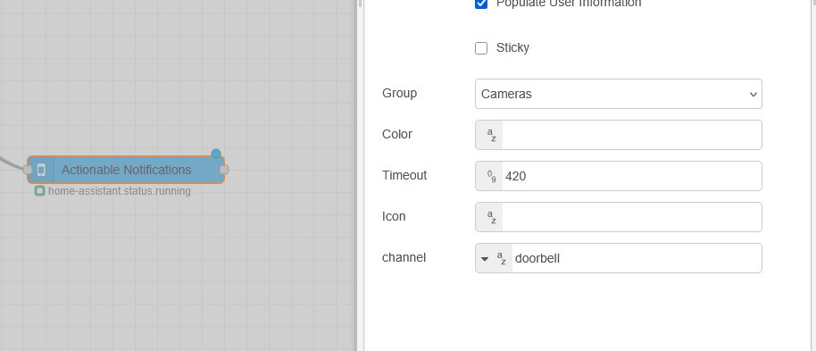

in a similar vein, I still have a node-red automation set up for my doorbell ringer (hope to convert it to a HA automation one day…) using actionable notifications. There’s an option there I was able to set called “Timeout” which will erase the notification after x seconds.
I’m not exactly sure how this works, let me know if I can share any other info from this flow that might be helpful:
