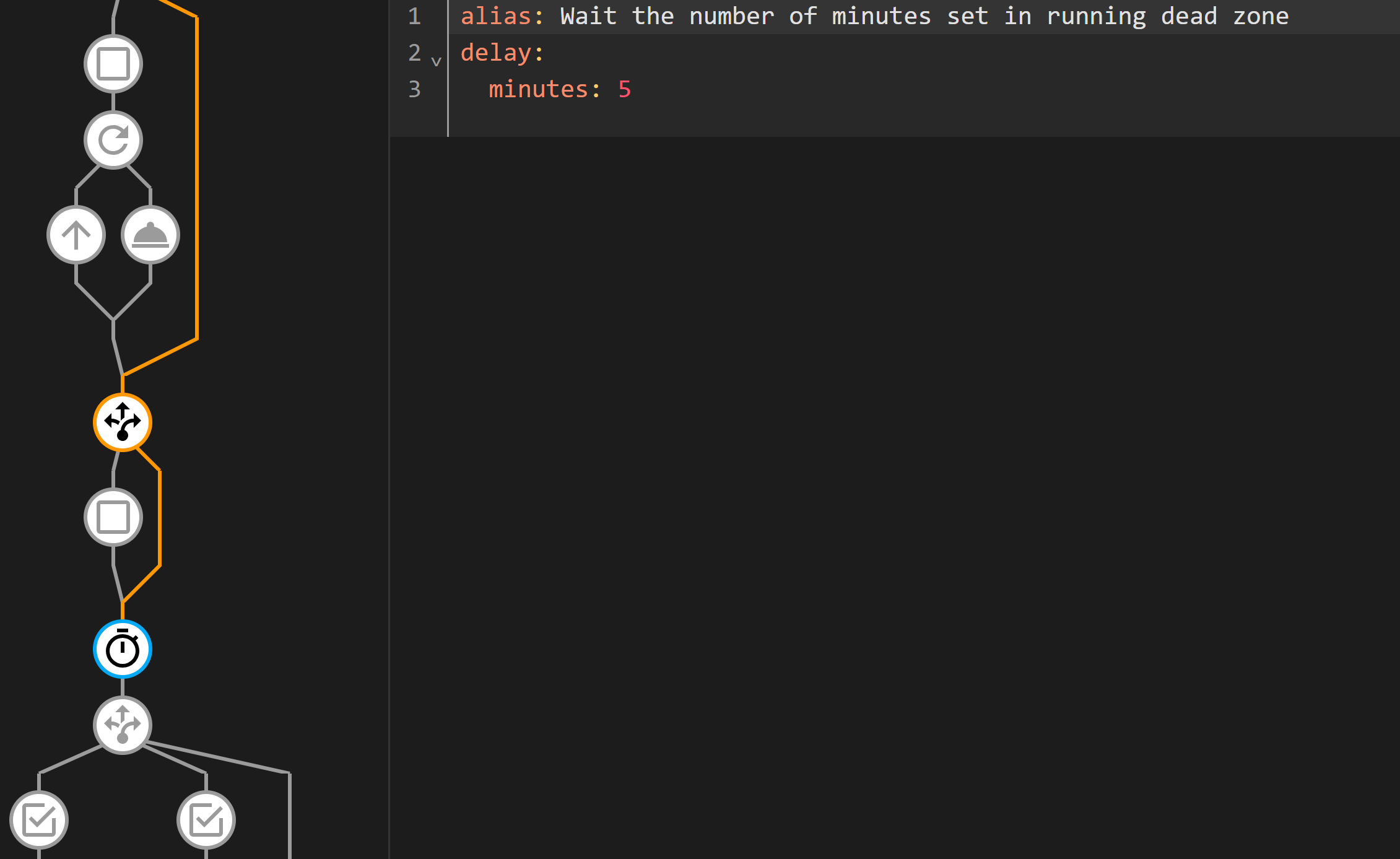

This is hands down the most useful blueprint I run, and invoked second only to the adaptive lighting one you wrote. But suddenly it’s not speaking at the end of the cycle. The automation trips. My phone gets a notification, but piper doesn’t speak anymore. I don’t think I’ve changed anything, as other automations that have piper continue to work.
My trace however, gets stuck on Watchdog, and disabling watchdog doesn’t seem to change anything.
@dunky13
Sorry Marc, I was going to look at it but didn’t :pensive:. Thanks for checking in again. I’ve got it now and had a quick look — interesting stuff. Let me do some testing and thinking.
My only concern is that users will need to know what to put in there, and I like my blueprints to be easy to use with no YAML experience.
Blacky :grinning:
@EdKennedyWV
Thanks for your kind words. This seams strange… could you please provide us your YAML of the automation? This YAML code are the settings you have selected in the automation so I can help. To do this go into your automation, top right 3 dots, Edit in YAML, copy all the code, come back to the forum and in your reply at the top tool bar click on ā€œ</>ā€ and paste code in there.
Blacky :grinning:

@EdKennedyWV
Thanks for your YAML of your settings.
It all looks good.
The run order of the automation is;
  1. I will skip the start and move on
  2. Watchdog… it goes past that step as you said your getting notified.
  3. It will start recording all the counts, service etc and you go past that.
  4. Custom end actions and you go past that. This is done before the end notification. I tested it here again and this works. You should see this in the trace an the heading is Perform the custom end action. Have a look there.
  5. End notification and you receive it so your getting to the end.
  6. It will then do the reminder 5 time every 10 min unless you open the lid and then it will clear your notification.
Blacky :grinning:
