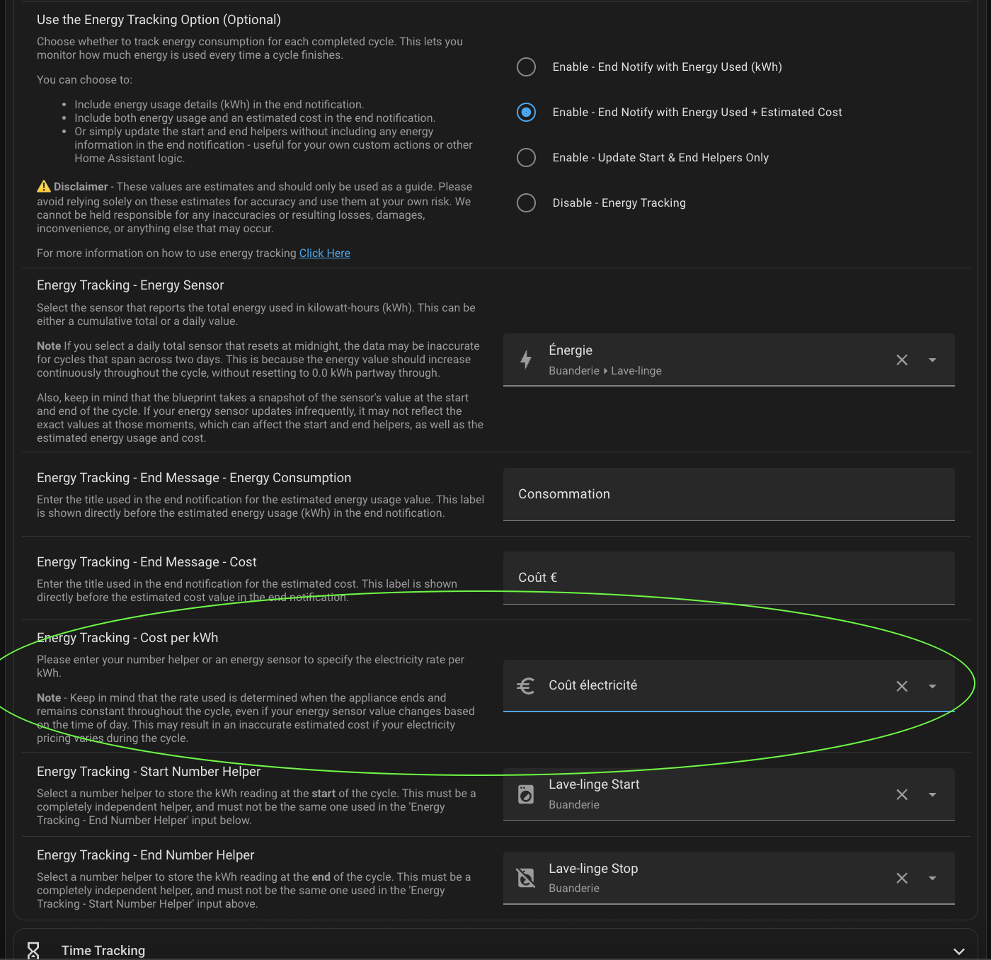

You’re close… just a couple of inputs need to be adjusted.
:zap: Power Settings
Power Sensor: You’ve selected sensor.lave_linge_energy, but that’s not the right entity here. This sensor reports total energy usage in kWh, not live power.
What you need instead is the sensor that shows the live power usage in watts. When the washing machine is running, this sensor will show the power fluctuating up and down in real time.
:dollar: Energy Tracking Inputs
  • :white_check_mark: Energy Sensor: You’ve correctly used sensor.lave_linge_energy here… nice job! :+1:
  • :x: Cost per kWh: You’ve also entered sensor.lave_linge_energy, which is incorrect.
    For this input, you need to create a number helper that holds the cost of your electricity rate (per kWh).
    :point_right: Click here for instructions on how to create a number helper.
Let us know how you go.
Blacky :grinning:

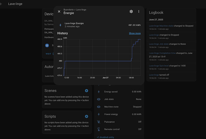

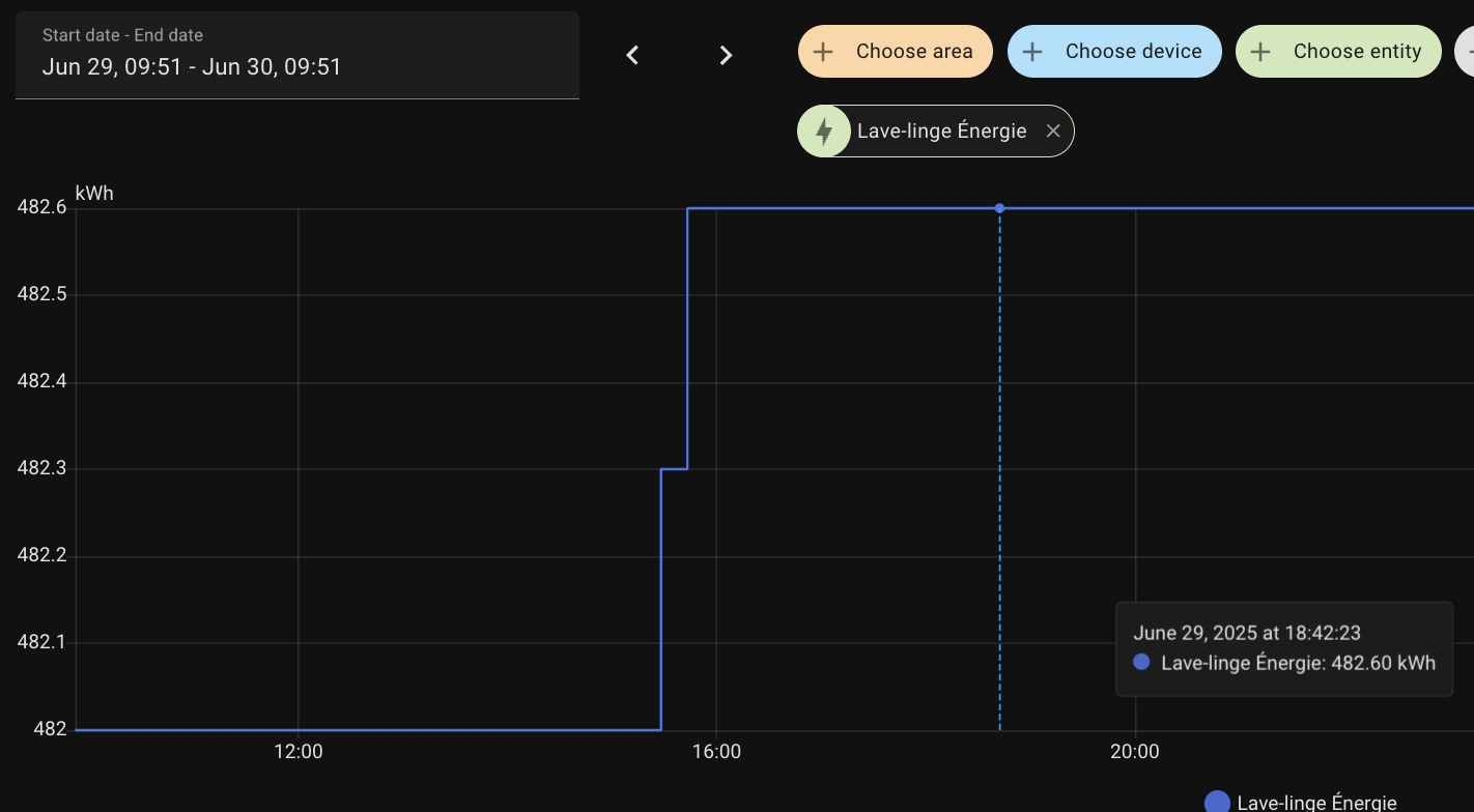

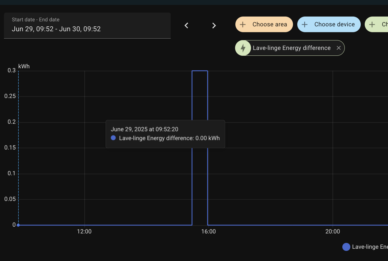

I have only this option for the Power Sensor :frowning:
Here are the type of sensors, I have:
Should I be creating a derivated sensor then to make it work?
2/ Merci I add created the number template but I did a mistake, which is now corrected thanks to you:
Merci

You will have to have a energy sensor that reads the actual power draw. Something like this click here
Blacky :grinning:
Bad news as I don’t plan to add an additional device just for that. As my device have a switch entity on/off and a select one with Running/Stopped I will use those to make a simple automation (maybe less realible).

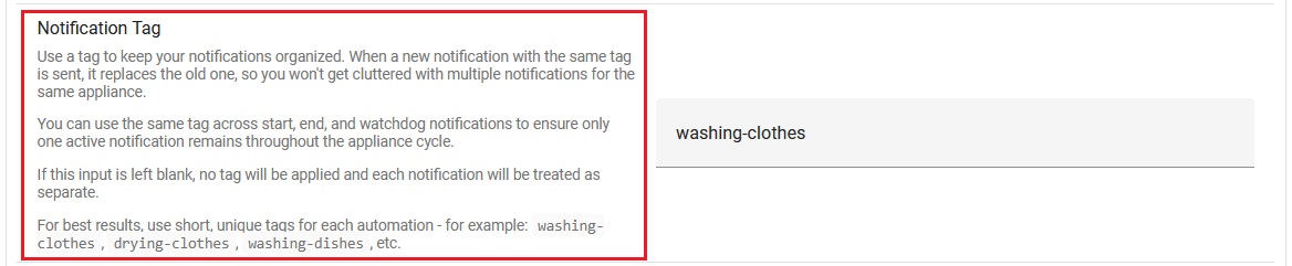

any idea how I could use the clear_notification function without changing the blueprint?
I mean the notification tag is already there, and I would love to delete the start notify message when the end notify message is posted. But I don’t know how as I can only add a tag for both.
@cptdaydreamer
What you do is add a tag like washing-clothes. You then use that same tag in the start and end Notification Tag input.
Blacky :grinning:
Oh, is the function already implemented like this? I didn’t know. Was it mentioned somewhere? Sorry then!
