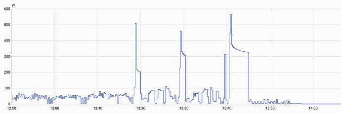

Thank you very much, Blacky! That looks like a lot of work you’ve put into that… :slightly_smiling_face:
Unfortunately, my knowledge of HA is limited. Should I copy the YAML code you posted and use it myself? I tried that, but the blueprint remains unchanged in the GUI. Shouldn’t it change in the GUI? I don’t quite understand what to do with the code.
My original request for help did not relate to custom end actions. :slightly_smiling_face: I understood the explanations in the first post here and elsewhere to mean that you automatically receive “end notifications” for cycle duration, power consumption (on the defined mobile device) if this is checked in the blueprint and all necessary helpers have been created.
But that just doesn’t work for me, and I’m looking for my mistake. Or maybe I completely misunderstood the description quoted. :upside_down_face:
@knuti1960
I just tested it here using a Android device as it looks like that is what you have.
What I noticed is along the top you have a green icon with the name Home Assistant then the time and a green down arrow. Click on the green down arrow and you should see it.
The updated code I gave you is for the persistent notification in your custom action. If you look in your notifications in the UI in home assistant you should see what you have on your device.
Blacky :grinning:
