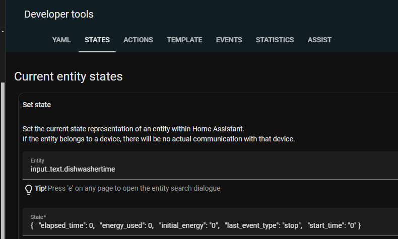

Hey i had the same error, its erroring because the elapsed_time_energy_data text variable (created when you setup the blueprint) is empty
to fix copy the following json into the entity via the developer tools
  "elapsed_time": 0,
  "energy_used": 0,
  "initial_energy": "0",
  "last_event_type": "stop",
  "start_time": "0"
That got me half way there, thanks!. However, the logs were still spitting out:

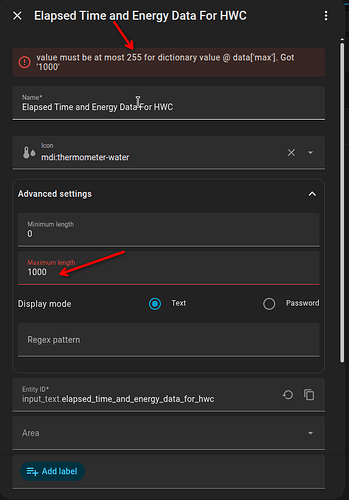

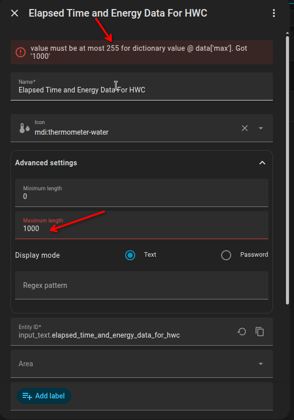

How are you able to put 1000, where for me UI errors out above 255?
Ok, luckily 255 should be enough, as this JSON payload is around ~140 chars:
{“elapsed_time”: 659, “energy_used”: 0.5671, “initial_energy”: “775.9308”, “last_event_type”: “running”, “start_time”: “1774594687.255955”}
