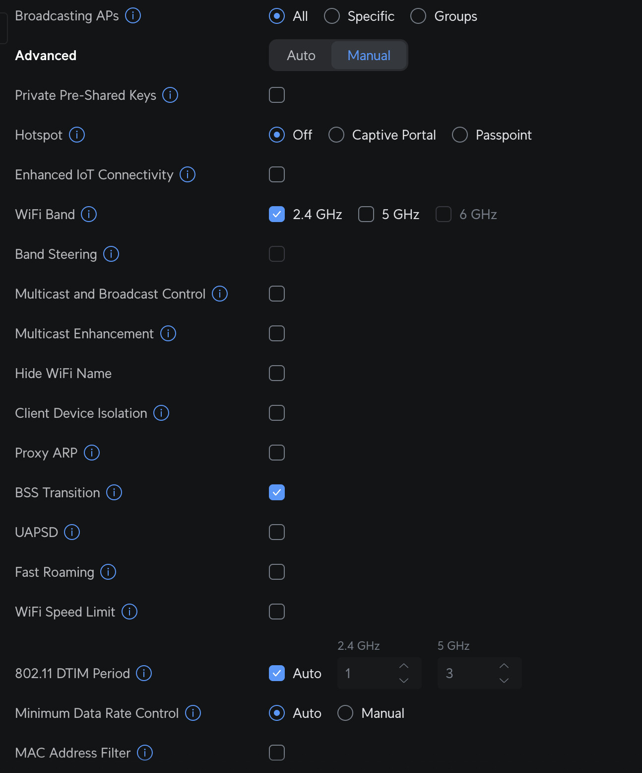

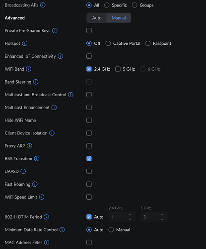

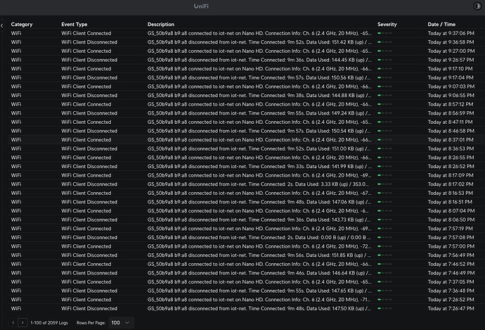

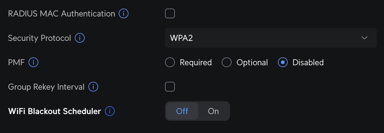

Ever since I switched my 8840M thermostat to automation mode, it’s been having Wi-Fi issues. It keeps disconnecting and reconnecting every 10 minutes, and it’s driving me crazy. I even created a separate SSID just for it, but nothing seems to help. The Wi-Fi icon on the screen stays a red X. I’m using UniFi APs with the configuration below, could anyone with a working setup share theirs? This has been really frustrating.
