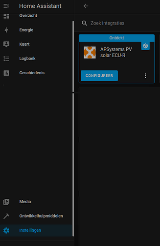

I now have installed the beta version v1.12:
Picture beta firmware APSystems ECU-R
Now it comes up under integrations as a new discoverd device:
