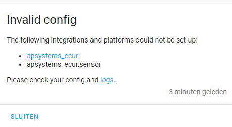

And look what pops up when restarting my HA server:
APSystems invalid config
I think when changing your configuration.yaml ->platform apsystems_ecur in apssytems like mine it should be working again. I’m gone try this config:
Let me now if it works
In log file it looks like this with the wrong config:
