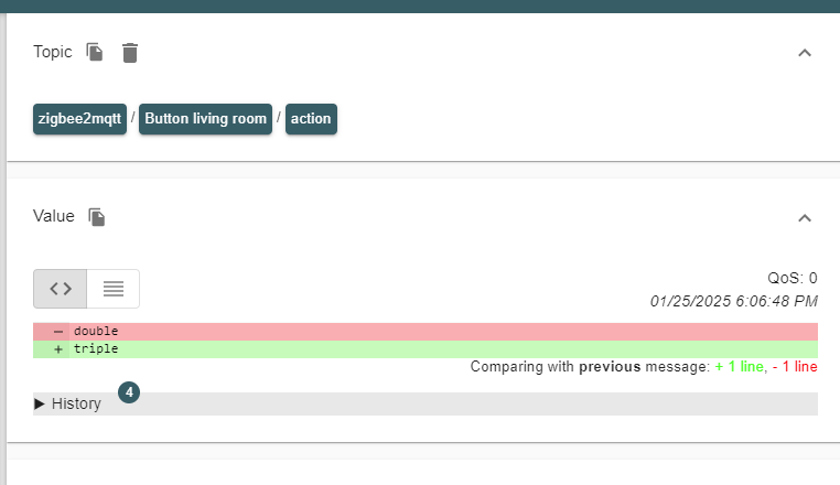

Using MQtt Explorer, I can see it is being published as well.
