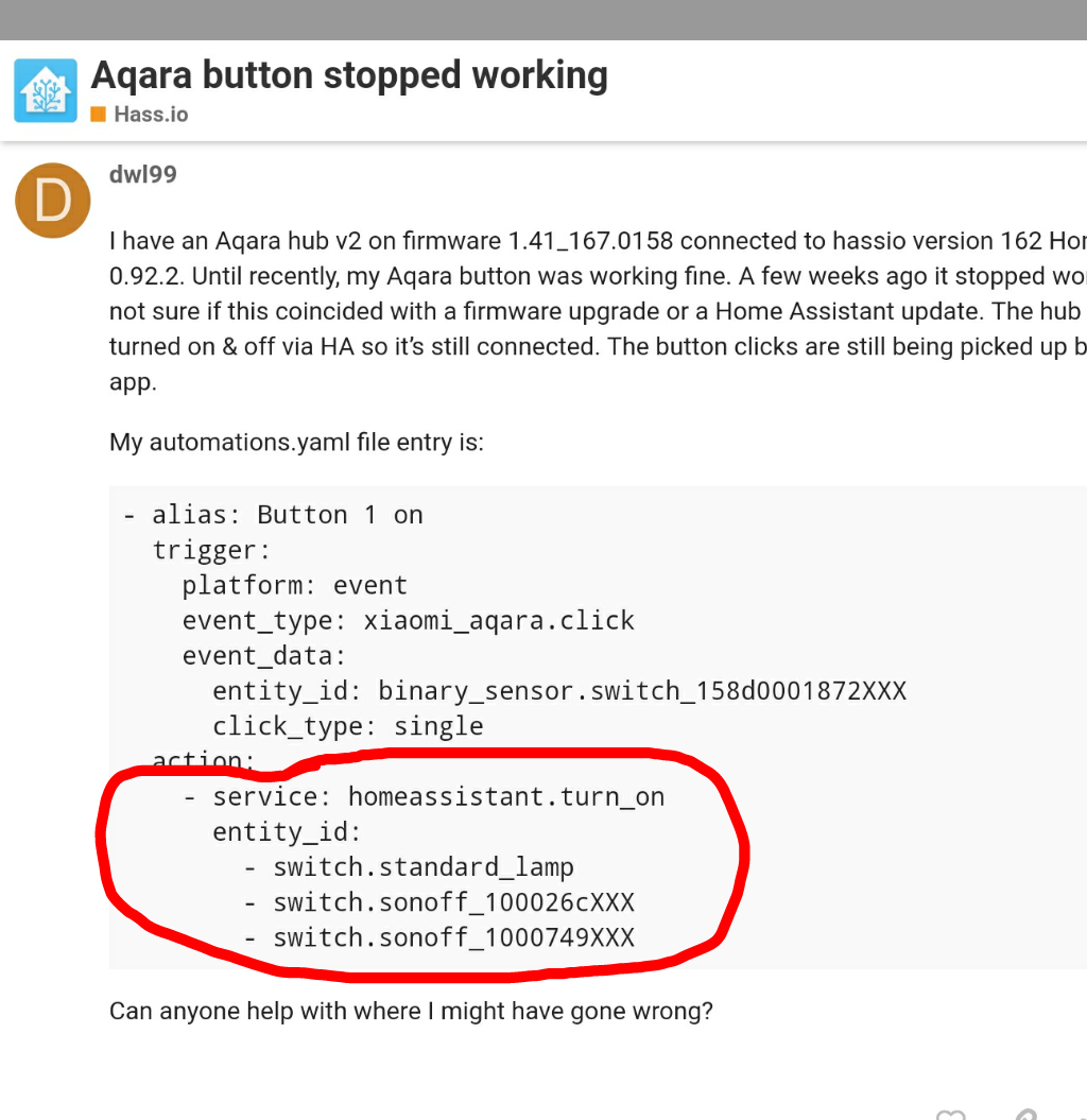

I have an Aqara hub v2 on firmware 1.41_167.0158 connected to hassio version 162 Home Assistant 0.92.2. Until recently, my Aqara button was working fine. A few weeks ago it stopped working and I’m not sure if this coincided with a firmware upgrade or a Home Assistant update. The hub light can still be turned on & off via HA so it’s still connected. The button clicks are still being picked up by the Mi Home app.
My automations.yaml file entry is:
- alias: Button 1 on
    platform: event
    event_type: xiaomi_aqara.click
    event_data:
      entity_id: binary_sensor.switch_158d0001872XXX
      click_type: single
    - service: homeassistant.turn_on
      entity_id:
        - switch.standard_lamp
        - switch.sonoff_100026cXXX
        - switch.sonoff_1000749XXX
Can anyone help with where I might have gone wrong?

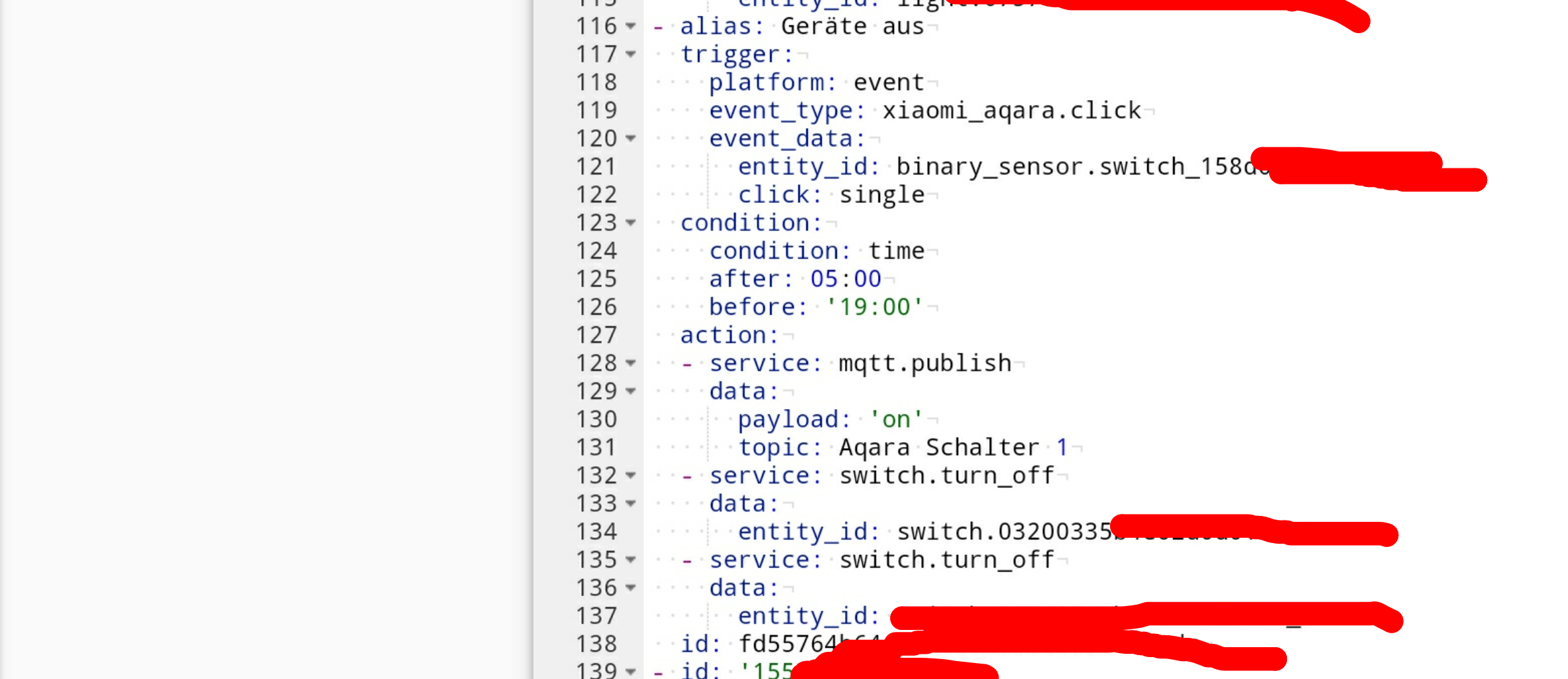

Hello, I’m not a professional, but have looked in my “automation.yaml”. With “event_data” stands with me “click” with you is “click_type” !! Maybe that’s why the button does not work. My Aqara buttons work and for me HA is running in the version 92.1
I tried changing click_type in automations.yaml and restarted HA but still no success. The States section in Developer Tools shows last_triggered: 2019-03-28.
Hello, It’s me again, compared your automation with mine again. I think your formatting is not quite correct?!? Please move your 5 last lines by 2 signs to the left. Maybe this helps
One Example from my “automation.yaml”
Or missing after the “- action:” the “data:” ???
