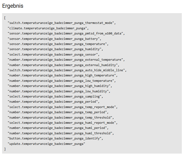

Hi, and thanks for the blueprint and your work. Unfortunately, the whole thing does not work completely for me yet. While I can control the temperature of an external device with the plus and minus buttons, the transfer of temperature and humidity from the external sensor to the W100 is not working. The following error is displayed in traces:
“Template rendered invalid entity IDs: switch.wohnzimmer - wandthermostat_display_off.”
Did I set something up incorrectly?

@clementTal
Since the blueprint suddenly stopped working for me, I used the error message in the trace to find out that the entity ending with “_display_off” apparently no longer exists.
After removing the corresponding code from the blueprint, everything is working fine again.
I’m not entirely sure what the action was intended for and whether it could be implemented with another entity from the list, but at least this way no more errors are generated.
Maybe this will help someone else with the same problem.
