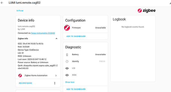

Can you please point where the ā€œscrolling logā€ is and what it should tell? In your picture I see your logbook is empty and so is mine which does not give me any information.
Below is snap shot of my device. How to know from my picture if it is in scene mode or action mode?
And I have the following in the signature of the device:

Activate the cube. Try to set action, shake it, these should all show something in the log.
Are you afraid of the thing? It’s not going to break. if you are tapping it or flipping it needs to be on a hard surface and you need to make it click audibly on the hard surface.
My log was empty because my ZHA cube is upstairs on my desk.
@Sir_Goodenough I see some event flying in logs so thank you for the guidence.
