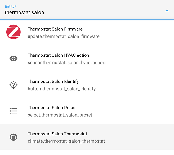

Here is the list of entities:

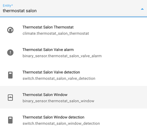

Here are the only entities I see.
The most similar one to the one I need is “Thermostat Salon Calibrated”
However it only shows if it is calibrated or not. I cannot run the calibration though.
Does anyone know how to run it?
It seems you are using ZHA. There is no calibration in ZHA for aqara. You might want to try zigbee2mqtt, there is a calibrate butten.
