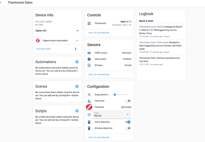

I am slowly removing all my Aqara accessories from the M2 hub and connect them directly to HM Green via Zigbee and the SkyConnect USB adapter.
Today I connected one E1 Thermostat.
It is showing -327,7C - colder than in Mars :slight_smile: But I’m on earth :sweat_smile:
Any idea what can be wrong?
It was functioning fine till one hour ago when it was connected to the Aqara M2 Hub.
I tried to run ā€œReconfigureā€ - but same situation
In the diagnostics json I see:

I’ve got the same problem, and strangely enough mine is showing the exact same temperate -327.7C, although that could be right, it’s bloody freezin where I live.
Just to let you know @seekman, I took the batteries out and calibrated again and all seems fine. I had tried this before but seems to be working now
