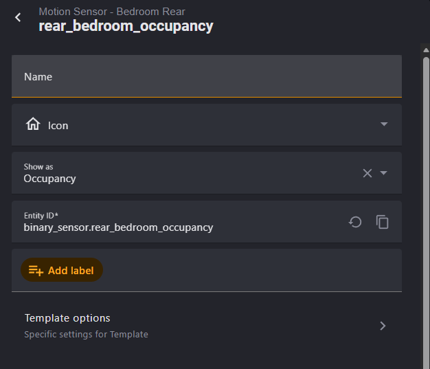

Yes, I’ve resolved it with a trick, and so far it works fine without a single failure.
I’ve created a template occupancy binary sensor that checks if the reported distance is greater than 0 and turns on the sensor.
template options is:
{{ (states('sensor.motion_sensor_bedroom_rear_target_distance') | float(0)) > 0 }}
Then, in my automations, I’m referring to this binary sensor. It’s 100% reliable.
