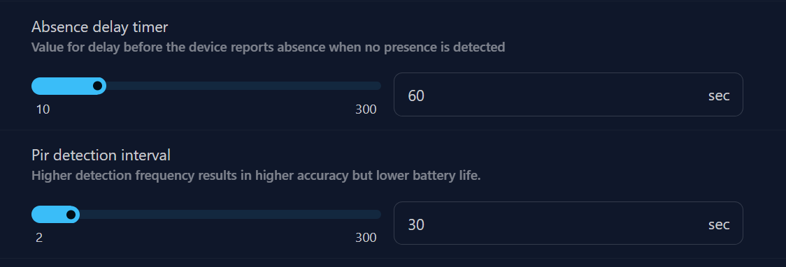

If it’s bothering you, play around with the 2 settings below.

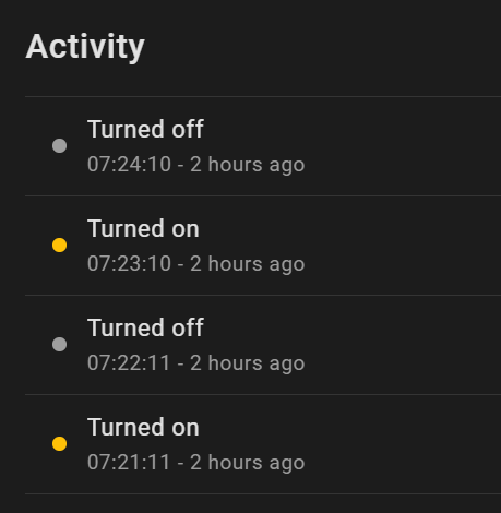

I know the first one mentions Presence instead of PIR, but I’ve been testing this for the past 2 months and it definitely affects the PIR reporting off states. In my case, all PIR triggers last exactly 60s with that setting above:
I did try changing the PIR setting you showed, but when I exited the settings screen and went back to look, it kept jumping up to higher delays. The adjustment I made just wouldn’t stick - like it is haunted. Maybe it needs time to “learn”? In any case, I was able to solve it in my yaml. Now, the light turns off 10-15 seconds after I leave the room even if the PIR is still on. Thank you for your suggestion.
Weird, never had that happen to me. Worst case scenario I had to wait a few minutes for the setting to take since the device needs to “check in” for the updates to be applied.
Yes, you need to trigger the Spatial Learning and make sure nobody is in the room for at least 10 minutes while it runs.
Might also be a good idea to ensure that “Ai interference source selfidentification” toggle is on when running spatial learning. I’m still not 100% sure what benefits this brings outside of the spatial learning, but I left it on just in case.
