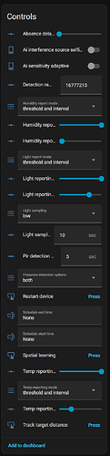

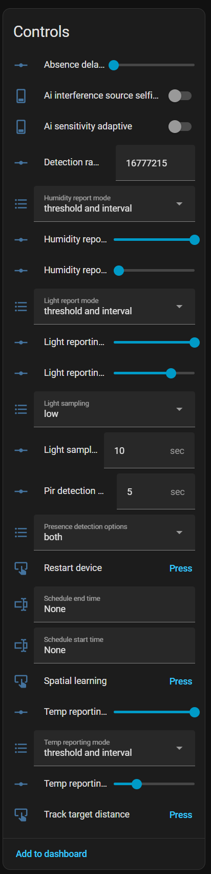

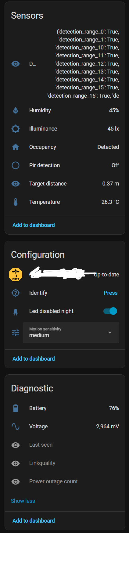

I got mine today and being trying it out. Was stumped at first as Z2M did not detect it and could not add to Matter. Did a search and found you need the Aqara app to set it up and you choose Thread or Zigbee and then it installs whichever firmware over Bluetooth. Seems to work ok, presence is pretty good and still trying out all the AI features (even with Z2M):

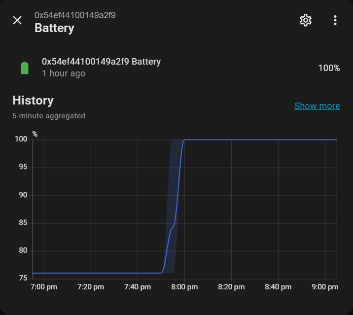

The battery reporting 76% on your first day has me worried a bit. Please post an update on whether it’s holding up whenever you can.
I was at 80% when I joined it with Z2M, I did set the interval quite low so I’ll put that back to default
EDIT, it now shows 100% !

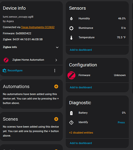

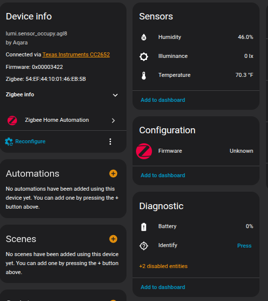

Does not work with ZHA. Only Temp Humidity and Light Sensors work. No Presence sensor is exposed. Battery and all other device info e.g. firmware version show as 0 or “Unknown”.
Thanks for the heads up. Looks like we might need a custom quirk which can hopefully be based on the FP2/FP1E.
