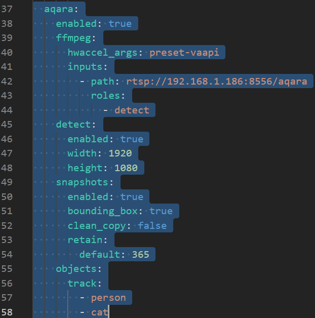

This is what my config looks like for one camera...at first glance, the main difference seems to be "enabled: true" on the camera itself, have no idea if it's still needed, but I always had it.
