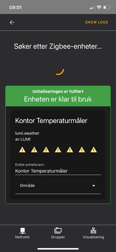

I have multiple Aqara sensors - both door sensors and temperature sensors. I can add them all to ZHA but only about half of them shows the actual values. For the other half I get these triangles and no values. Any idea why this happens? I’m using a Conbee 2 stick and recently moved from Deconz to ZHA.

I’ve followed this guide and done all of this. I also planned the Zigbee network throughout the house with router devices and repeaters to form a solid network. Conbee 2 stick is on a USB extension without any interference. All other devices are working flawlessly. It’s just the last 4-5 Aqara units that refuse to send the values. Very frustrating.
I guess I just have to try again and again…
