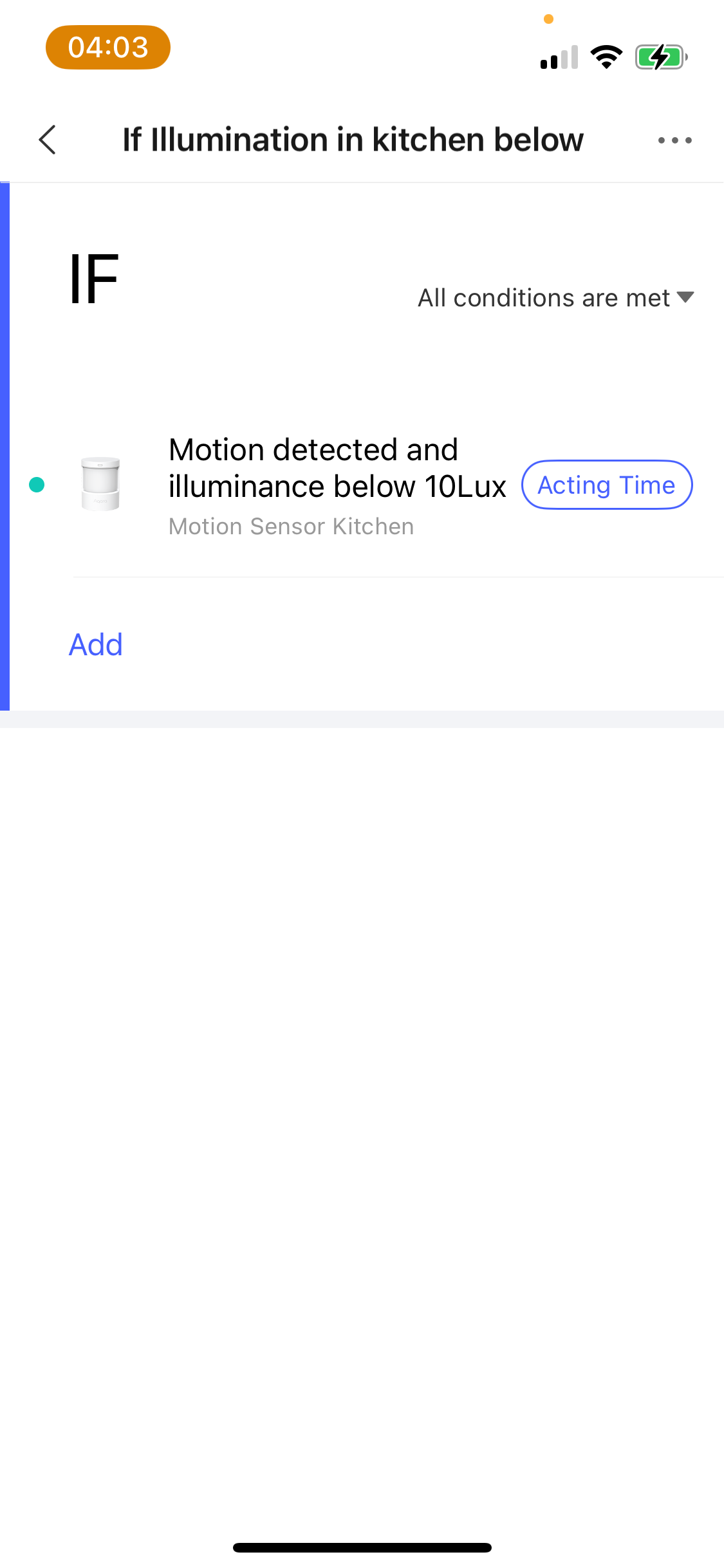

I have found a workaround for this with a limitation.
Since beginning of this year aqara allows you to sync signals over matter. For this you need a compatible Aqara hub to achieve this. For this to work you do need to expose your aqara hub over matter into HA.
Aqara signals are basically triggers that follow an if statement. In the aqara hub you can configure the signal. Go to profile>Connect to ecosystems>Home Assistant. Here You can create and sync this signal to matter.
Create a new signal in signal magament. For example:
Once you have configured your signal, you can sync it to matter using Signal sync. HA will see this signal as an Occupancy entity.
The limitation here is that you setup a trigger based on when the lux value is above or below a certain value. You still can’t read the lux values.
