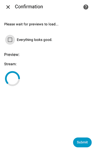

Can you let us know the location of the guide? My setup hangs when it tries to generate the stream image in the second stage of the setup.
Did you ever find out how to do this?
just check the ā€œeverything’s okā€ box and submit
I’m into Frigate now myself, as to Generic Camera, just click submit if you can, it doesn’t always show a preview.

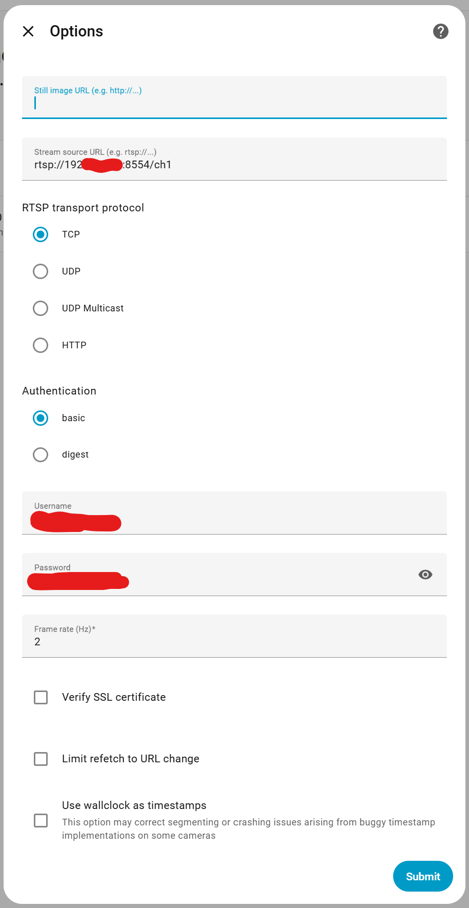

Below are the steps I took to connect the G100 to the HA.
  • Installed Aqara Home on my phone and connected the camera to my network (I saw the camera’s image in the app).
  • Enabled RTSP for this camera in Aqara Home (after enabling it, you’ll see the addresses/port for the 3 channels and the username/password).
  • Configured the generic camera integration as shown in the screenshot below.

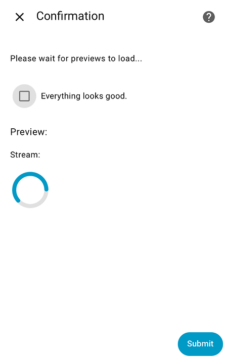

  • When the following screen appears, check the checkbox and click submit (even though the stream doesn’t appear).

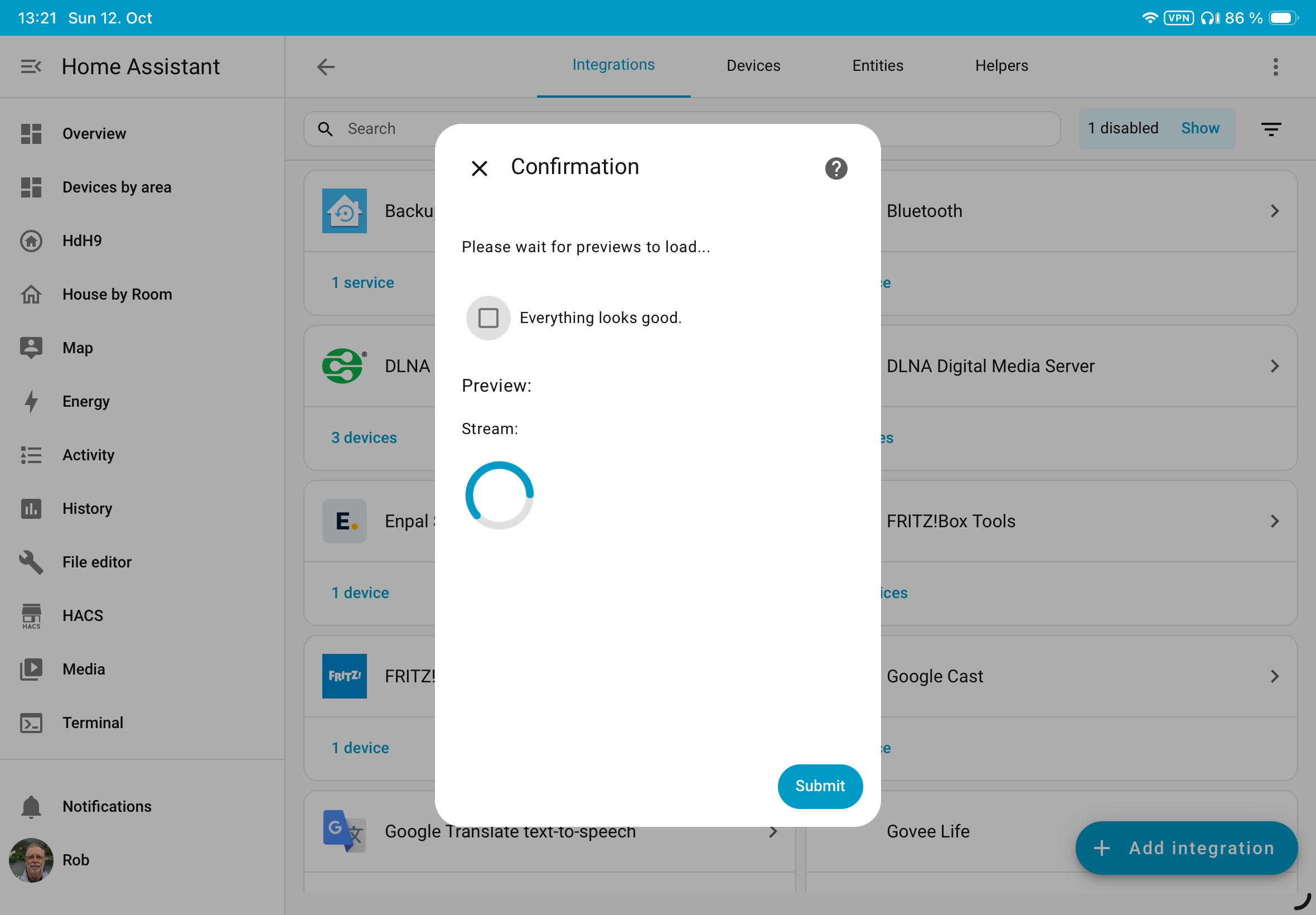

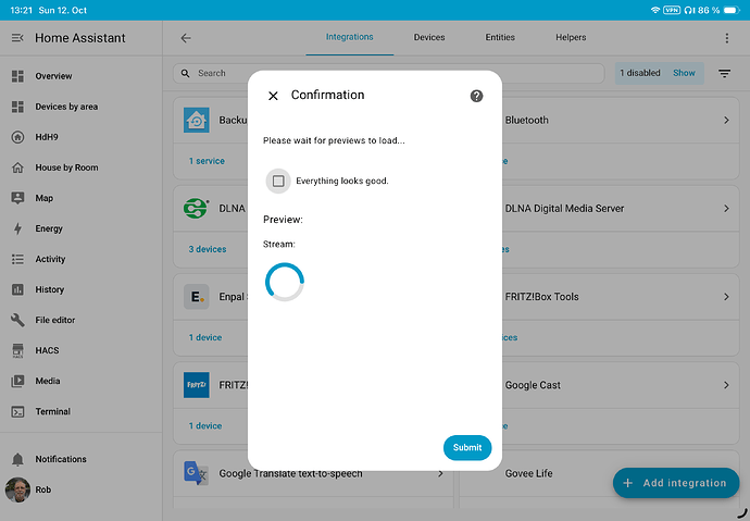

When I try it. I don’t get the second screen. got a error message ā€˜Time-out loading URL’
Did try all the options.
