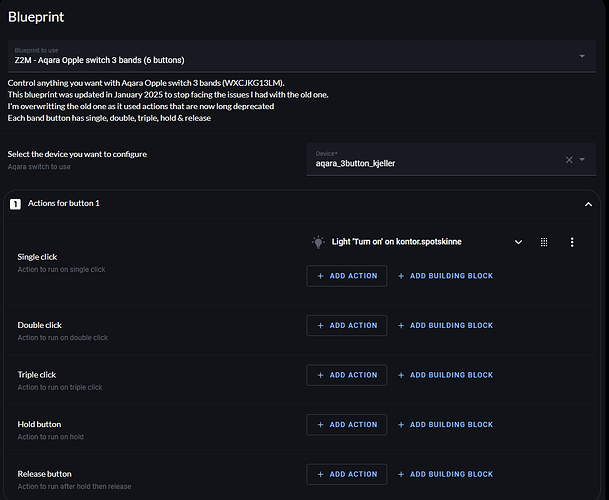

Thanks for great feedback - not getting it fully there yet. Since this is very much a GUI approach I tried this based on your input:
Should this work? “kontor.spotskinne” is my spotlight entity in the office. It’s a light group of spot-bulbs.
No. Your lights cannot possibly have such an entity id, as it must begin with “light.” and the rest of the id can only consist of lowercase letters, numbers and underscores (no additional periods). Also you must put the entity id on a new line prefixed with entity_id, my example was from a blueprint using a target selector.
- action: light.turn_on
    entity_id: light.kontor_spotskinne
Sorry, that was a typo on my side. I have primarily been working with gui and then it just shows as kontor.spotskinne. You are correct, it’s called light.kontor_spotskinne.
However, it still doesn’t work. It looks like this now:
