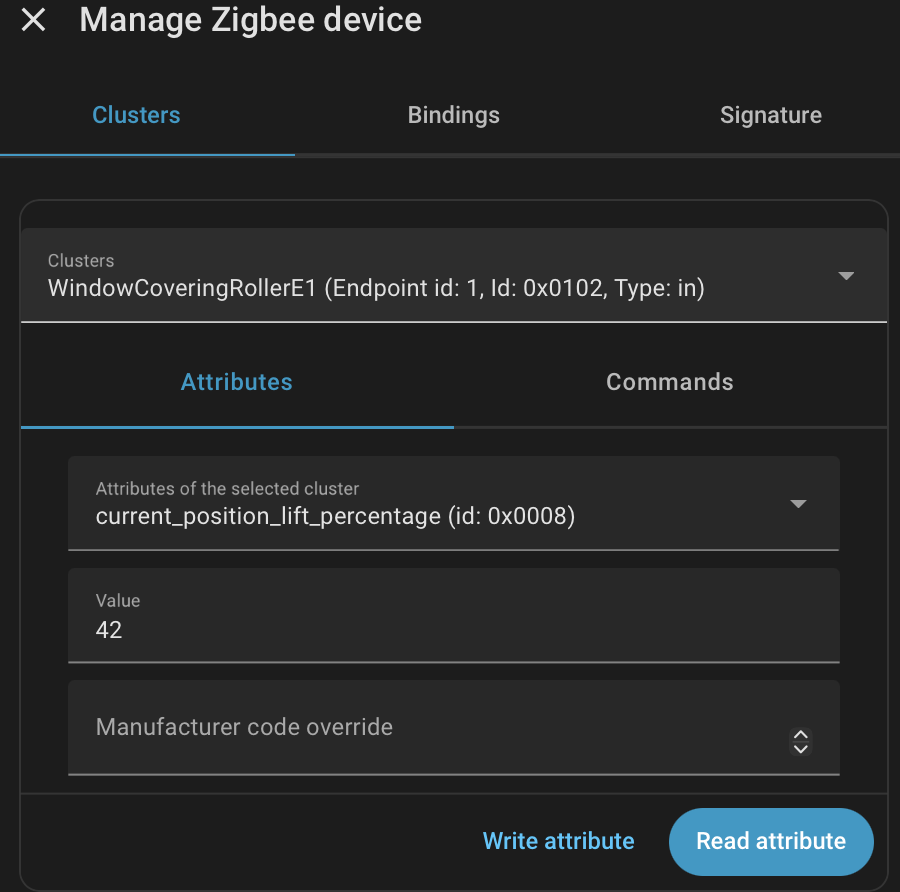

  2. Also, to check value of WindowCoveringRollerE1.current_position_lift_percentage you could find your device in settings, then (for ZHA):
    Device Info > 3 dots (right from “reconfigure button”) > Manage Zigbee Device >
    select WindowCoveringRollerE1 from cluster and select attribute current_position_lift_percentage > Read Attribute.
    After that, you will see the current value of this attribute.
If your roller have position in real life different from the value of current_position_lift_percentage, so it could be the issue, but I don’t know for sure.
In my case, ZHA just stopped polling position from WindowCoveringRollerE1 after updating firmware and start polling from the AnalogOutputRollerE1 cluster, which has correct data.

find out you can refresh state of the cover when you read following attribute
if a action like read zha attribute exist, we could do some magic with automatons.
that would be nice ,
I don’t understand why the function has disappeared, because it has worked in zha previously.,
Now I’ve got it! When you press stop, you always get the current position.
