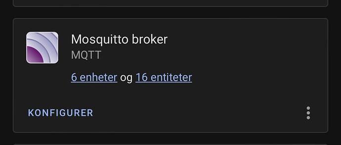

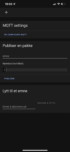

If so, I think if you head to ypur mqtt in home assistant, and then configurate, you can send those packages there maybe?
