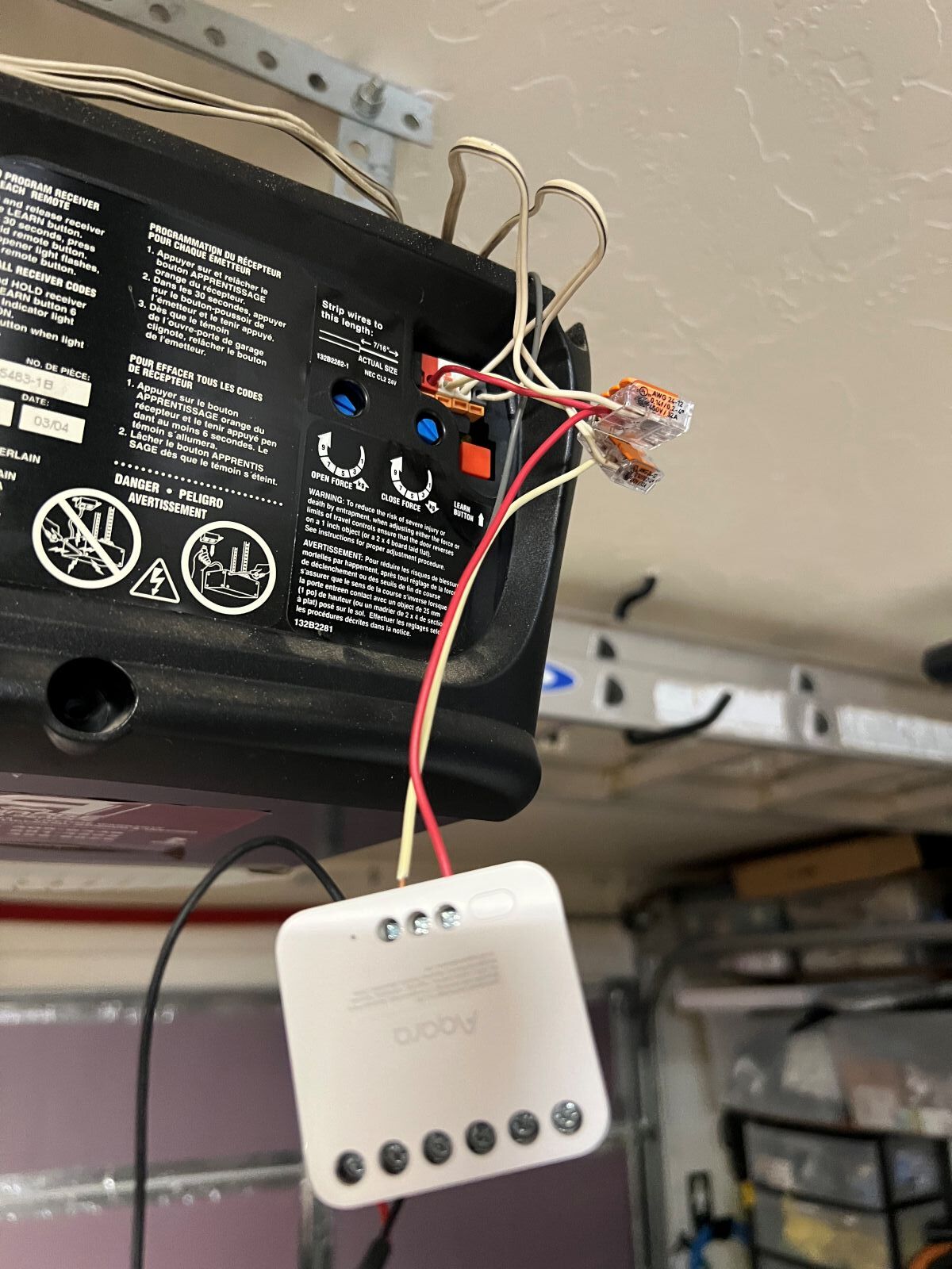

Cant figure out why the relay isnt opening the garage door.
If I short the Security+ Liftmaster opener on the wall, the door opens OK.
Wired up the Aqara as follows: (and the wall opener works as normal in this configuration to confirm)
Its connected to COM and S1.
I have it set up in home assistant as Dry and Momentary, however it just never opens. Any ideas? I hear the relay firing but the door doesnt open.

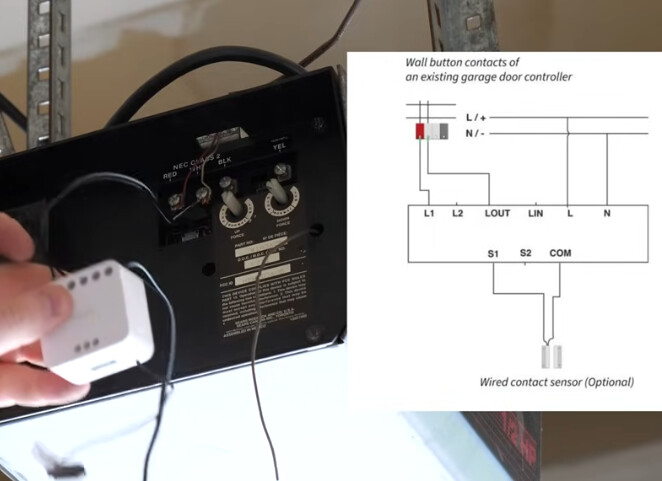

You are using the wrong connector ports, the 3 you are plugged into are for physical switch inputs.
you need to use the other side connectors for the relay to pass function to the garage opener.
That did it thanks!
