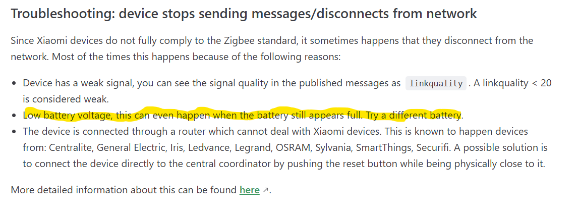

Try replacing the battery.

The problem occurs with my second aqare temperatur sensor aswell, so I asume it’s something wrong with my setup. I tried changing battery, but that didn’t make a different.
