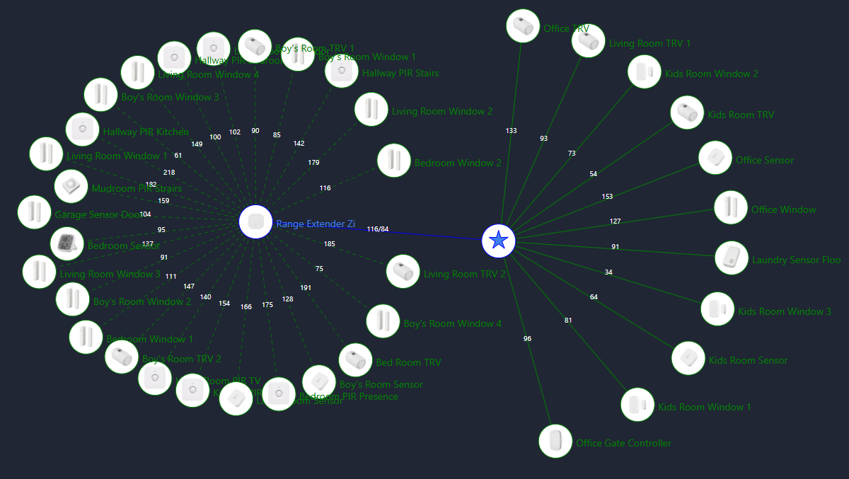

thank you for the reply. I have z-wave and zigbee (z2m). Zigbee i am using only SML 06 and aeontec repeater. See the picture of my map. Strange behaviour was when i added repeater to network i had to re-adopt all zigbee devices.
You’re gonna need at least 4-5 more repeaters mate. Space then around your house - you’ll need around 1 per room. Any mains powered device like a smart plug should do if you don’t want to take up a socket with a repeater which doesn’t do anything else. It won’t be as great as your range extender, but it has multiple uses at least.
